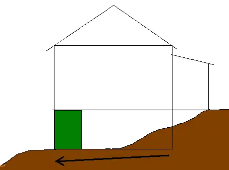

All - thanks for the replies!! I really appreciate it.
The drain thing is a great point. I don't know if it applies to my house or not. Ill probably have an inspector come take a look before I do anything drastic.
I've drawn a rough sketch (in mspaint!!) of a side view of my house. The green representing the proposed room, the arrow representing the slant, and the brown representing the hill I live on. My basement opens right up to the back yard and the whole basement slants toward the back yard. Ill have to get a line level and figure out how many inches we're talking here.
Thanks again everyone.

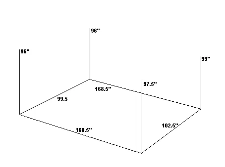

OK - so I took the measurements, and Ive been doing some research for solutions.
Ive attached a drawing of the length of the walls and the heights of the corners (in relation to the floor/ceiling joists above.)
I don't yet have a laser level to see what the actual difference is from corner to corner - but the floor/ceiling joists were level, so these measurements seem fairly accurate.
So it looks like the I'm dealing with a 96" wall to a 99" wall at worst and a 96" wall to a 97.5" wall at best.
Would self leveling concrete work in this situation? and if so - can anybody reccomend a brand? and possibly prices/place to buy?
Also - does anyone have any experience with 'DriCore' subfloors from Home Depot? The have a raised polyethylene underside and they clip together. Seems interesting.
