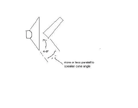

Right. If you want to run the amp louder, you can back the mic off some and open up some distance.
This is a little drawing I made (don't laugh, this mouse sucks to try and draw with) of the ballpark I seem to wind up in when miking an amp up with a 57 or similar dynamic mic. seems to generally work good most of the time. I may have to wiggle it around a bit depending on the amp, but it's been a good starting point. Sometimes it can be hard to see through the grillecloth, so you have to feel for the edge of the opening and make your best guess.
Sometimes I'll add a MD-421 Sennheiser pointing straight into the center of another speaker of the cab, especially if I want a bassier tone like when I'm doing blues stuff.
