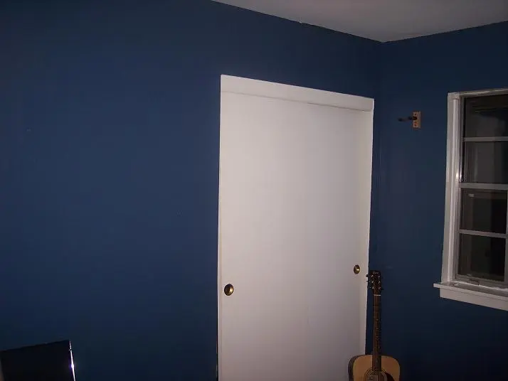

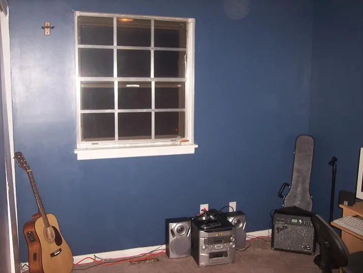

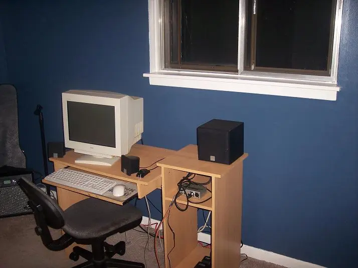

I just moved in recently and need some ideas on what to do with this room. It's real small, so there's not a lot of room, and the house is also being rented.
The dimensions are about: 12'width, 8'height, 8'length
I'm guessing some bass traps in the corners, and maybe some high-frequency absorbers on the big walls?
I'm new to this, so someone help me out.
Here's some pictures of the room:
Edit: I forgot to add that I'll be recording just acoustic guitar with 2 mics. I'd like to isolate sound coming in from the door and also treat the room for recording guitar.

> I'm guessing some bass traps in the corners, and maybe some high-frequency absorbers on the big walls? <
That's a start. For the complete story see my Acoustics FAQ:
www.ethanwiner.com/acoustics.html
--Ethan

as far as monitors are the ones there what you mix with?
the stereo on the ground would be better than the computer speakers
