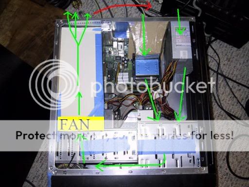

I thought I'd post this - some of the crudest handiwork I've taken part in since
I was 9 or 10 years old.
It looks bad, but it works well - a single large diameter fan with/heat sensitive speed, cools the cpu, the power supply the hard drive & the video card.
very, very quiet.

I don't mean to be the bearer of bad news, but I really doubt that'll be adequate cooling for the entire computer, including that as the CPU's sole source of cooling.
I would keep a close eye on how hot everything is getting.
I made a diagram showing how I think you made it work. One problem is that the ari behind the PC will cross-contaminate the cool intake with the exhaust.
I would try to find a way to make it exhaust out the front. But even then I don't think the power of that one fan will be enough.

thanks for the comments guys, glad you enjoyed it.
thanks for the diagramming tarnation sauce, it does make it much easier to
portray what I am doing.
I actually works quite well in practice - internal box temperature is
94 degrees (72 ambient), and the fan seldom spins up above it's minimum RPM. It's been (a potential fire hazard) working 24/7 for about two years now, cross my fingers no real problems.
I actually used diagonal cutters (dykes) to rip out the back of the box..... you know how it is when you are excited, and it would take an extra hour to dissassemble the box and use a jigsaw. I'll probably do a better job on the next DAW, however far in the future that is. This is a 2.4GHZ pentium,
and I've tested it up to 48 tracks of 16/44, so it's going to be a while before I
reach the limits (maybe never).
