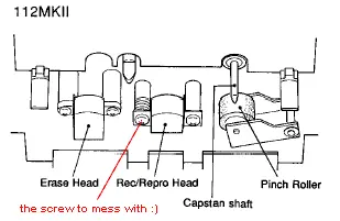

he's getting two-headed machine
/later

Sorry, Dr Zee is right. I thought you were getting the 122.
Dont turn the screw anticlockwise too far or the screw will get to the end of its threads and you probably wont be able to get it back in easily.
Also, dont overdo turning the screw. I heard of an overzealous user who wore out the thing by turning it repeatedly back and forth. They're probably not designed for repeated turning so just be gentle.

Dr.Zee, thanks for the diagram. I found that in my manual and was pretty sure that was the screw, but it's nice to have confirmation.
