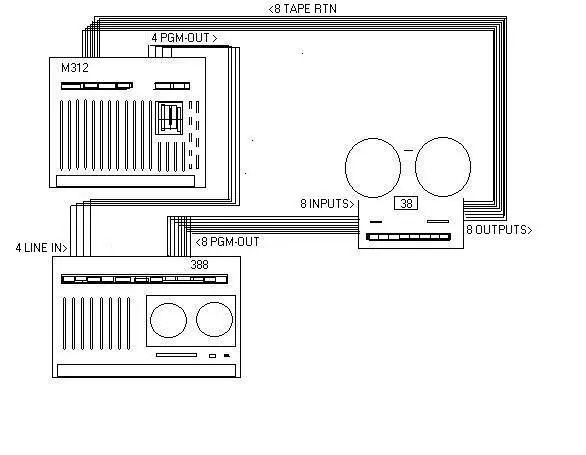

Arrow I'd say,...
Use the M312 as a "front end" submixer for up to 12 inputs mixed down to 4 busses. Then, route the 4 (PGM) Buss-Outs from the M312 to 4 Line-Ins on the 388. Use the remaining 388 Mic/Line inputs to come up with your 8 PGM (tracks) on the 388. Record in 8-simul to the 1/4" built-in reel recorder on the 388, AS WELL as on the 38, by routing the 8 (PGM) Buss-Outs from the 388 to the 38's Inputs. This enables you to record in 8x8 (8-inputs-to-8-tracks) onto the 1/4" reel and 1/2" reel simultaneously. For 8x8-simul recording, that's a pretty sweet setup! You end up with two first generation master reels, on their respective formats. Or, on the other hand, it gives you the choice of either one format or the other,... depending on the scope of your project and/or tape budget.
The second idea is to record all "live" primary tracks onto the 388 and 38 simultaneously, which you then take each reel and overdub tracks separately. In this configuration, the "front end" and first steps could be virtually the same as above. While using the 388 as Main Mix for it's 8-buss capability, then routing the 388's mixer's outputs to the 38 for overdubs,... the caveat is that you want to split "CUE" from the 38 off onto it's own circuit, and thus avoid creating an unwanted feedback loop between the Cue Mix and the Main Mix. This is handily achieved by using the TAPE-RTN/SUBMIX section of the M312. (The overdub/cue mix on the 388 in standalone mode is 100% internal).
That's how I'd do it, anyway. With dozens of Ins and Outs, and several separate sections on these mixers, the diverse patching is almost unlimited. It's a bit hard to describe patching and methodologies on a bbs, and understanding my notes would require a fair knowledge of each unit,... which only comes with time. Nonetheless,... take these notes and see what you can make of 'em!

Arrow Like this:...

Arrow Yeah,... I was waiting for my kudos for that diagram!!!
Thanx!!............
Yeah, you could drop the M30 in the place of the M312 & it would be virtually the same.
DISCLAIMER: This is only one proposed use of the M312/38 & 388 together. I'm sure there are more configurations that would work for slightly different setups that do basically the same thing.
PS: The diagram took me about 1 hour on MS-Paint, though I don't claim to be an expert. I thought a picture would cut to the chase,... by fleshing out my explanations above.
