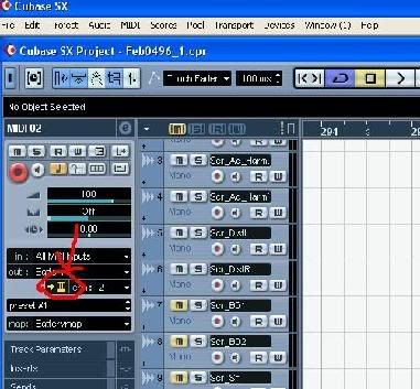

Hey there is there anyone here who has done drum programming in cubase?
If so, I'm trying to find out if anyone knows how to access the "explode" function that is supposedly under score layout or something. I can't seem to access it in my version, I have Cubase SX. I went to the cubase sight, but it's pretty vague in the searches I ran and it seems to indicate it might only be in VST 5.0 or something.
All I'm trying to do is find out how to take a midi drum track and adjust the levels of the seperate pads seperately, ie: turn up snare, turn down bass drum, apply effects seperately, whatever. If there is a different way to do this that people use other than the explode I would like to learn that too.
Thanks for the help

Not sure if I'm thinking of the same thing....clicking on the circled button with the arrow pointing at it should open up your drum sampler window where you should be able to alter the levels.

Sorry I altered my post. See above Again not sure if I'm thinking of the same thing
Well, here's the thing, I think what I saw on your pic was a general midi volume level. but I don't think you can alter the volume within the same track on different types of drums, for example the ride, High hat, cymbals,snare.
Or does it let you do that if you use the LM7 thingy??

The yellow thing in the red circle i drew usually opens up the drum sampler or whatever midi instrument you are using when you click on it...or at least it does that with battery and the LM7. My pictures a bit crappy, heres a better one...
