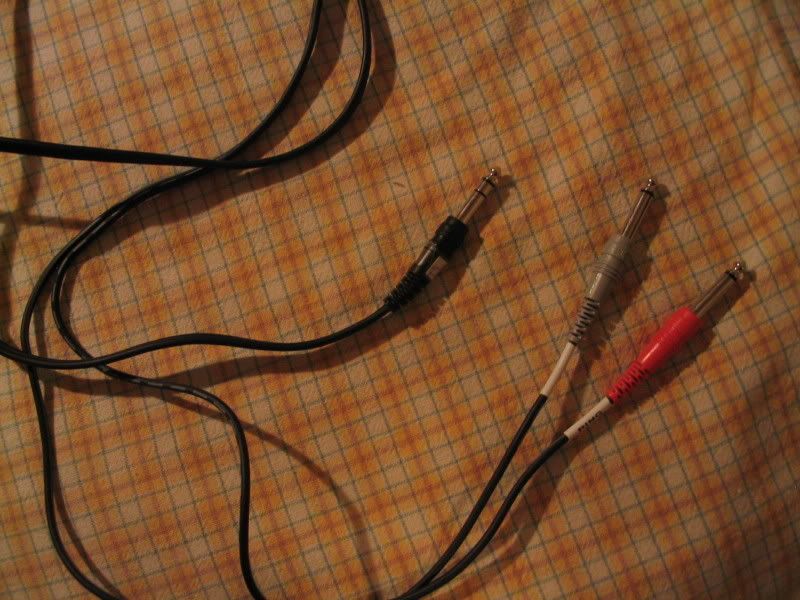

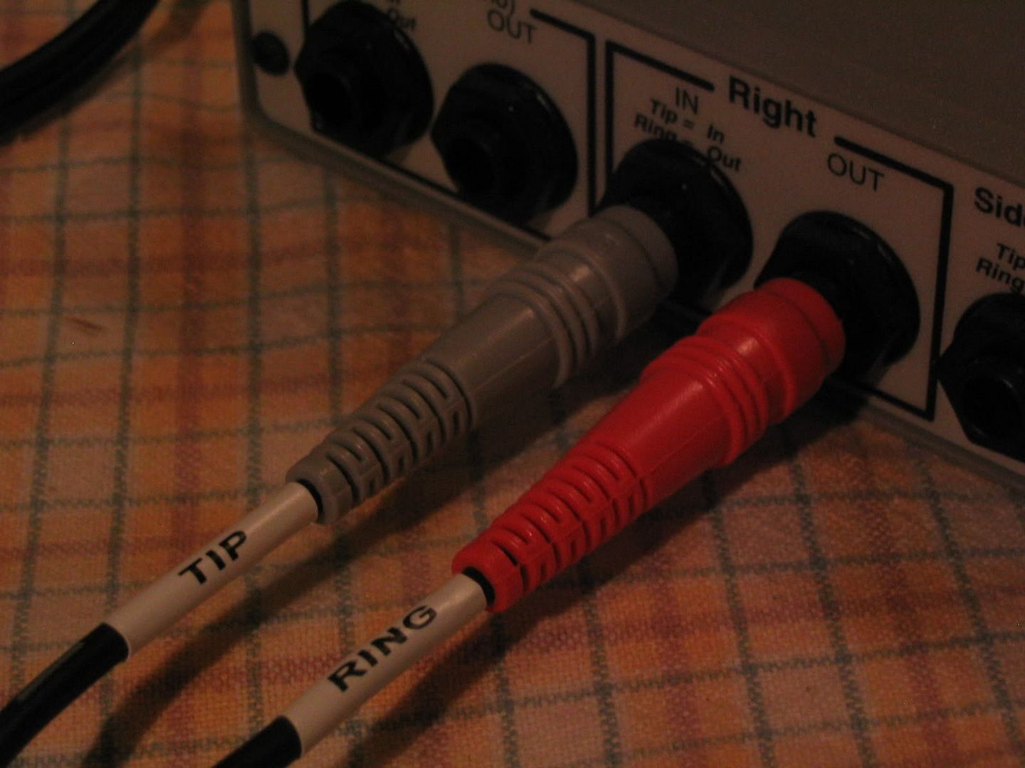

Yes. The signal should be sent from your firepod insert jack out through an insert cable to your compressor and it will be returned through the same cable.
Firepod insert jack->insert cable->insert tip plugs into compressor in->insert ring plugs into compressor out->signal is returned to firepod through the same cable.http://i71.photobucket.com/albums/i1...ertcable-1.jpg
http://i71.photobucket.com/albums/i1...ttum/cable.jpg
