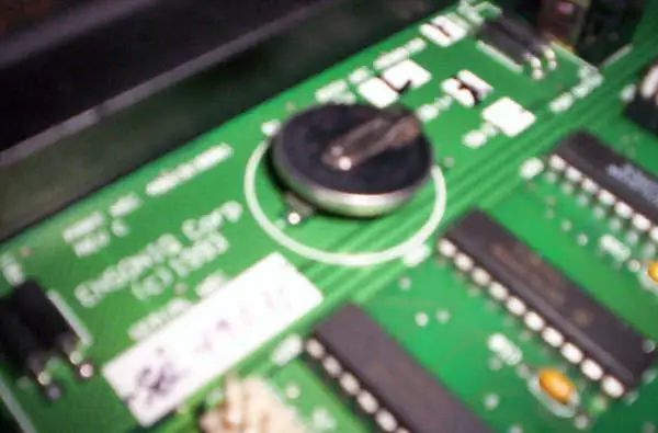

hey everyone..i'm really more of a guitarist but i have this synth that i bought a couple years ago and it farted out on me...it has been gathering dust for a year and i need to do something.
the battery died..it powers up but it gives me internall battery is dead..
i figured it would be a watch battery but has this clip attached to the circuit board????? there is a post here with a similar replacement battery but how to replace is my question????
it seems to be one peice..i tried to pry it out...no luck..is this a common battery in synths??? a watch battery that needs a soddering job????pure bullshit.... ..i can't find nothing online and the music store can't help either..
i have a pic at this link and i will try to attatch the pic as well,,thanks

In the ensoniq sq-1 (and sq-1+) the original battery is soldered in. Unsolder it, and note where the + and - connect to the circuit board. (although it should be written on the circuit board itself)
I went to Radio Shack, bought a battery clip holder and soldered that to the circuit board with a couple of short jumper wires. The replacement battery is a Lithuim CR2032 (radio shack and panasonic numbering)
My SQ-1+ was made in 1991, and I'm on my 3rd battery right now (not too bad for 15 years). The only data you loose is the sequencer data and the INT sounds (ROM sounds remain).
It wasn't that big a job to do, in fact when I first had to replace the battery around 1996 or so, the music store instructed me how to do it, instead of sending it in for repair.

I would recommend replacing it with a battery clip if there's physical room for it. It will make things a lot easier long term, since you'll never have to unsolder the thing again.
For example:
http://froogle.google.com/froogle_u...wOJAxlxzcABdR1KMu7M0sjwAAAAAAAAAA&gl=us&hl=en
That holds a CR2032, which should be close enough for just about anything in that form factor.

yes i just installed the BATTERY HOLDER LITHIUM CR2032 by dgatwoods instructions...
i had to take the circuit board out and remove the old battery..and while sodering the new holder in i had to get my wife to push hard on the positive side as i heated it...then i got the other side alone...but these post are large compared to the neg and positive holes... thats why i had to put the pressure on the new clip while soldering...it works like new, and now changing the battery will be much easier for now on,,thanks again everyone
