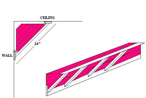

I think just hanging broadband absorbers on the existing wall (that you can take with you when you leave) would be more feasible. As for the angled wall you can accomplish the same thing by making a wooden frame that you can screw (not nail) into the existing wall and stuff insulation in it for bass trapping. I'll draw what I mean and edit this in a minute. Be right back...
Alright, how's this? Just screw the 1x4 plates to the wall and ceiling studs then screw the diagonal 1x1's every 24". Load the cavity with 2'x4' 703 and staple up some burlap to cover it up. Get the idea? When you move just unscrew everything and redo it at the new place.
