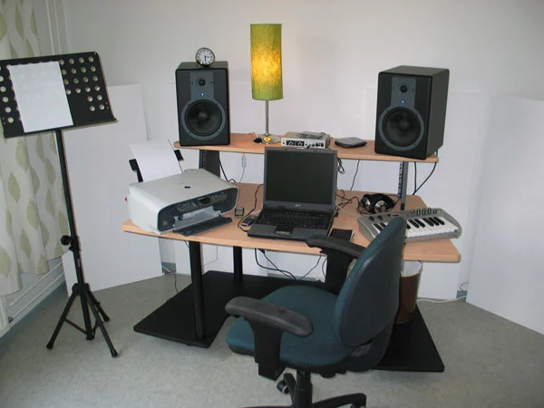

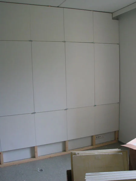

The situation's changed now. I really could use some help still. Anybody? I've thrown in the bin the idea of a diffusor. The room's pretty much too small for that. There's two pics of the room as it is now.
I've covered most of the back wall with 10mm and 30mm acoustic tiles (with a 50 mm airspace behind them). Also I have four of the 30x600x1200 mm tiles on the wall and in the corners behind the monitors. They're just laying against the wall on the floor, long side up.
I can clearly hear some (lower) notes booming in the room when I sing. Not to a terrible degree, but enough to disturb practicing and definately recording. I ran a pretty basic acoustics test and the analysis shows big dips in the mid-to-high end. I don't think it actually tested the low frequencies at all, since the curve was pretty straight.
Also, when I play a low sine wave synth sound through the monitors, I can hear some of the low-mids are vanishing, but the very low notes are booming (of course).

If you are hearing bass problems you should invest in bass traps made of 703 rigid fiberglass, you'll hear a big difference and be pleased that you bought it. Makes life much easier knowing the bass frequencies are being tamed. Also if those are the bx8s, they sure do make my bx5as look tiny!

That link doesn't work for me, but yes, you want to put bass traps in the corners and broadband absorbers on your parallel walls. Like Shout said, OC 703 is highly recommended around here. Anything with similar specs should work just as well, and what you choose will depend mostly on the prices and availability from your local suppliers. Here's a helpful comparison chart: http://www.bobgolds.com/AbsorptionCoefficients.htm
