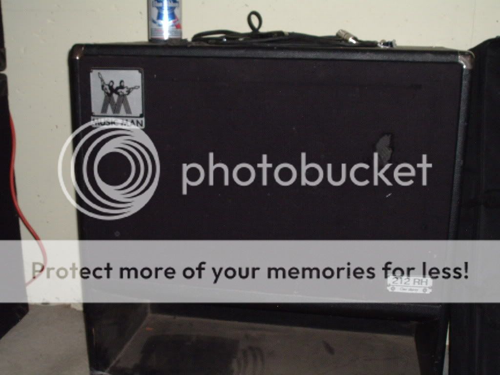

Musicman 212 RH One thirty:
My amp has 4, 8, and 16 ohm outputs.

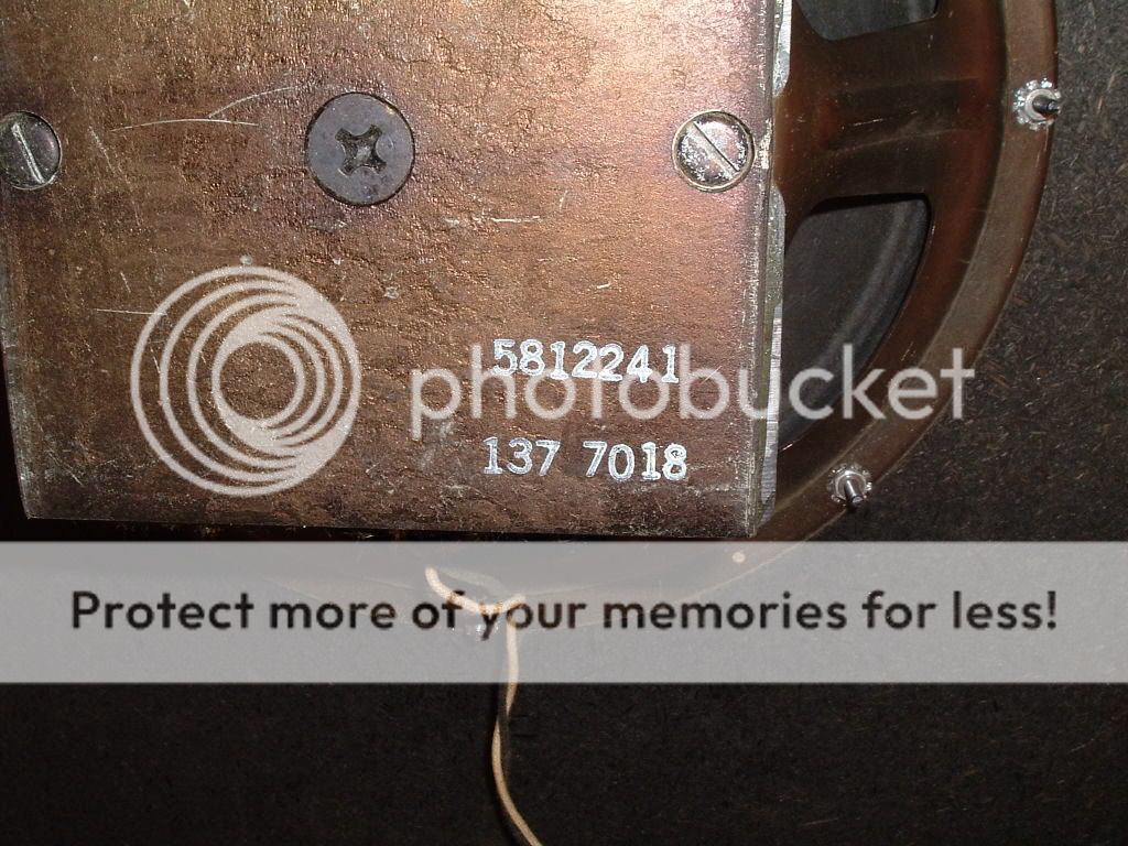

Pyle Driver? musicman cab.
Isn't this a car stereo speaker?

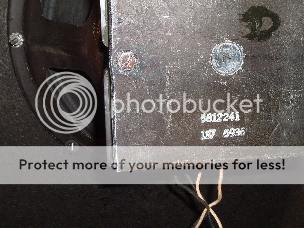

Here is the other one:

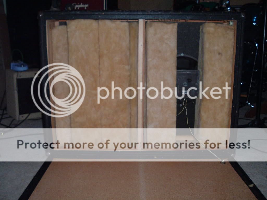

Bandmaster cab.

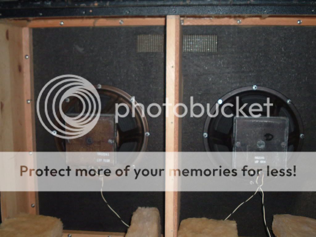

The speakers look like this.
Numbers.
Also, what would happen if i took some or all of this padding out?

sure these are stock?
Those don't look anything like what I recall being in my band masters. I know for sure mine did not have square magnets on them. I believe mine were manufactured in the late 60's so they could have switched manufacturers.

according to this guy they're 1969 and 1970 CTS part #'s. And I think it was only 130 screws to get the back off, and my electric screwdriver lasts for about 1 minute between chargings...

Well if you want to know for sure what the ohms are just do what the other guy suggested and measure the resistance at the speaker jack.
Do you have the head for that amp too. I sure wish I had a few of the old tube amps I use to have. ;(
Or since it appears in the pick their wire in parallel you could measure the speaker impedance and divide by 2.
