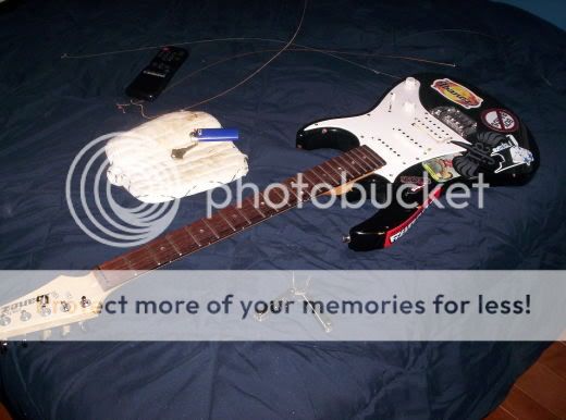

For all do it yourself enthusiasts, here is my "out of nowhere" fretless guitar project! Note: I'm doing this simply to inspire others, and give people here an inside on how things worked out with this guide.
Hopefully im doin' someone alittle good! ...Oh and check out the site i found first to better understand what im working with here.
Backround Info
After much bordom I decided i needed some sort of project to help pass my time. And after a sort discusion with a friend on fretless guitars I googled for a step by step procedure to remove frets
(yes, i know i am following directions, but its still a big project for most, can't that be agreed on?) .
I found: http://www.unfretted.com/loader.php?LINK=main
which is a awesome reasource for all things unfretted. I then spontaneously took out my old, cheep, starter electric Ibanez:

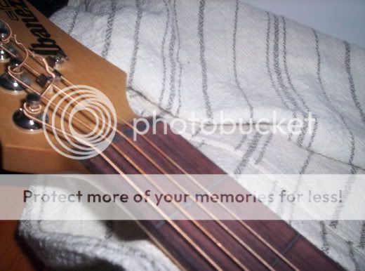

My Ibanez Before
a close up on the frets
The Steps

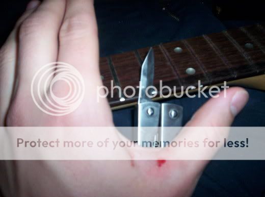

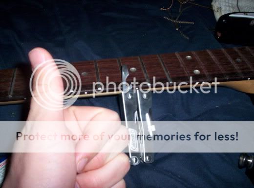

I first did a few stupid things like held a neadle with a hotpad to a lighter and then placed it on a fret (i dont have a soldering iron) to loosen the glue. But i quickly realized i was an idiot and tried a knife. Turns out that my frets werent glued in and they came out pretty easily, untill i cut my hand, and (midway) decided to use a bottle opener for saftey (pointless pictures below)
the knife and cut
The bottle opener (you can see that its edge isn't too thin, so you shouldn't worry too much about thickness when removing the frets)

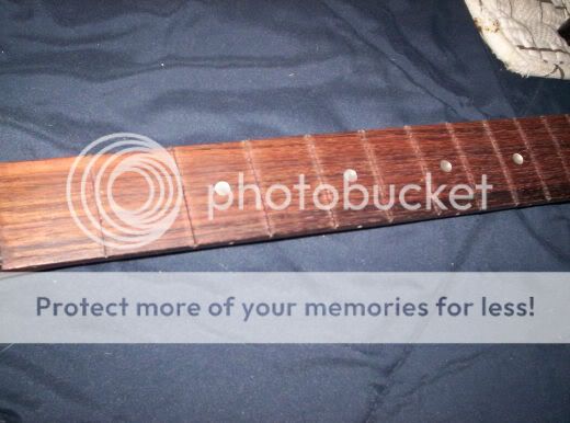

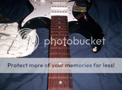

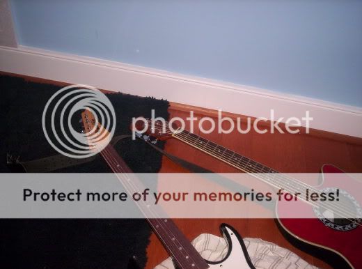

Here are pictures after i removed all of the frets:
no frets one
no frets two
no frets three
Where I Am Now
Here is a current cross road for me & anyone filling the frets [remember, i am not yet finished]. On the main page for the project im doing
(http://www.unfretted.com/loader.php?LINK=unfretting) they say epoxy should be used for filling frets, and then sanding and yeah...
But, in the hint section they recomend to use a wax crayon and then to polish the fret board.
WHAT!!! that really doesnt make since. But anyways, im going with the epoxy rout, and for the first time, not being lazy...
(hopefully this way will work best).
Tomorrow im going to go a local hardware store for:
~ 15-30 min epoxy
~ some sort of small mixing containers (i'll probly use somthing small from home though)
~ toothpicks (hmm)
~ Double sided tape (duct), ive got the scrap flat pice of wood
and then "various grits of sand paper" (80, 100, 150, 180, 220, 300)
~ and masking tape to cover the guitar.
wish me luck and I'll keep you all posted on my progress, it says it will take around 2 days for the epoxy to fully dry (but i'll talk to the guy/girl at the store and see what they think, and maybe ill do alittle reasearche too) but i'll post the work ill do periodically over the next 3-4 days.
-Harry

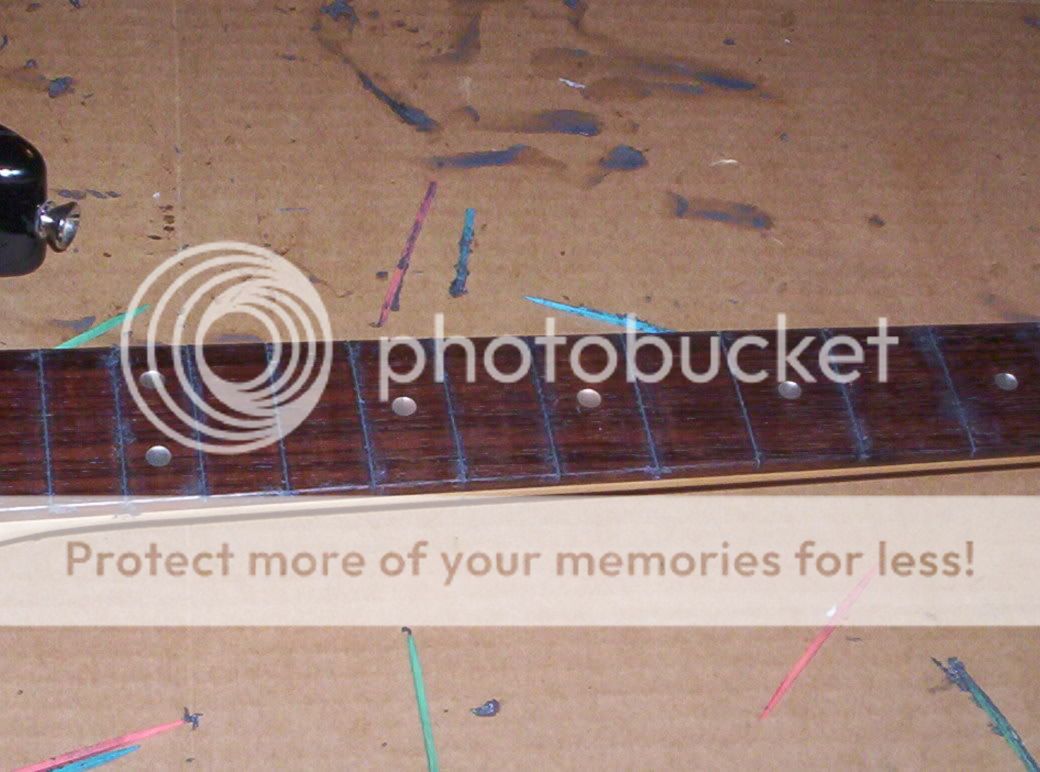

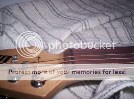

So ive got the epoxy and i put it in the empty slots...
pictures:
Close up 1
Close up2
Close up 3
(it looks kinda blue 'cause of the flash, but it should dry a grayish black)
It was alittle messy, the stuff i used, "PC 7 Epoxy Paster," was really hard to work with.
---so does anyone have any sanding tips, like i said, im pretty new at everything. Is there any spacific that i should focus on?
I'll have to wait 'till tomorrow so the epoxy can dry. But any suggestions would help. Same with just a commment on what you think.

I've done it!
okay, of course the epoxy has dried. no it didnt take me this long (sorry, ive been lazy, and been having fun playing it.)
But heres what i did.....
after the epoxy dried (just took about a day, rather than a week as it said<i think>). I basically used three grains of sandpaper. I actually got it at cvs in a pack (i went: 60, 100, 150 and thats all i needed.) I was surprised on how well it came out with just those three, rather than the 6 or so that i was planning on.
i just went with the grain and was careful to do it evenly (and also get the sides of the fretboard). Heres a pic of it upclose when i finished:
http://i15.photobucket.com/albums/a3...Picture001.jpg
It looks nice and natural. You can see the frets but thats actually an
advantage because to play the notes in the right pitch you need to press where the lines used to be. Im actually likeing the freedom and theres a werid effect i get from simple 2/3 note chords, like powerchords and such.
As you could have guessed the action was way way way too high. so to resolve this i lowered the bridge dramatically, and actually sanded the nut down some too. And heres a pic of that:
http://i15.photobucket.com/albums/a3...Picture003.jpg
http://i15.photobucket.com/albums/a3...Picture006.jpg
Nothing too dramatic, hah, and also: im sure i'll like playing it more when i get new strings (im supposed to get flatwound ones) that arent used acoustic ones.
heres 3 last pictures of it:
http://i15.photobucket.com/albums/a3...Picture008.jpg
http://i15.photobucket.com/albums/a3...Picture010.jpg
http://i15.photobucket.com/albums/a3...Picture011.jpg
id recomend doing this, its wery werid, but wow those old strings are crappy, i mean really really bad, so when i get more ill let everyone know. Also, if anyone would like a sound clip, just ask.
to summarize it, its a cool, simple project that is pretty fun and wont ruin your guitar. i did it to my old starter that wasn't getting played...at all. so why waste that old guitar thats sitting in your room/garage/attic/ect, im gonna atleast be picking it up more out of curriosity, oh and it can do some nice bass frequencies so if i ever was to need a bass part, id probly be set!
(note:when sanding w/ epoxy, use one of those face masks...i just saw it on the epoxy container and figured it would be a good idea to be safe about it.)
-harry
