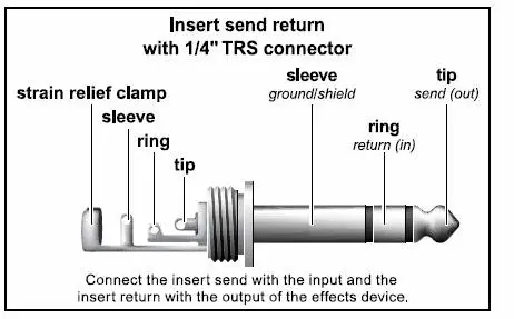

I hate the first-click thingy, to insecure and potentially crackly. The contact that hits the ring on a TRS connector is usually not designed to "hold" a plug, just to make contact with it
So I just soldered a few cables with TRS cables to RCA (card inputs are unbalanced), but instead of wiring to tip and sleeve as usual, I soldered the signal cable (centre of RCA) to the ring-lug, and the ground to the sleeve-lug. Now you can push the TRS plug all the way in, so that it is secure, and still use it get a signal out.
Cheap and best, but of course it helps having rudimentary soldering skills (or a friend who does). Parts can be found in any radioshack.
