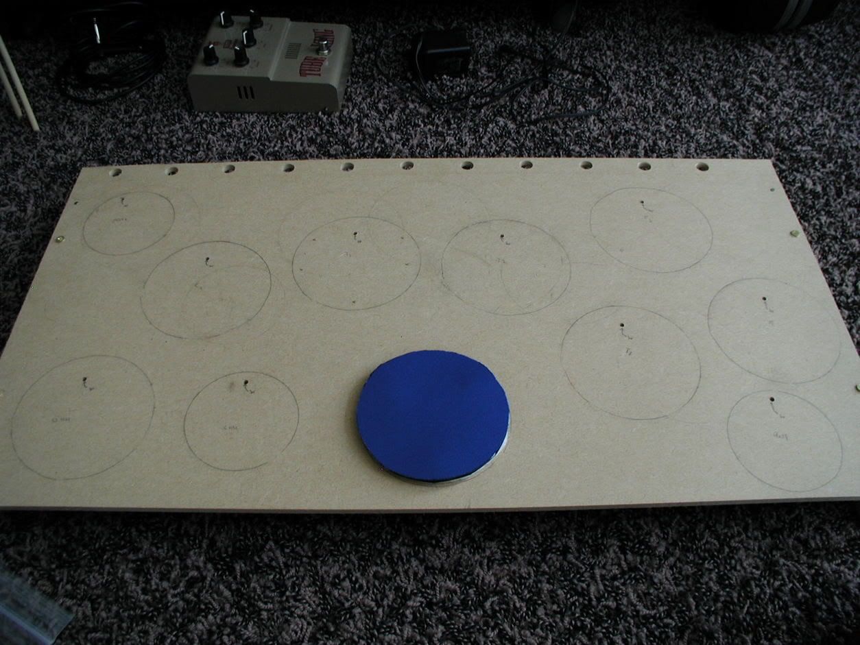

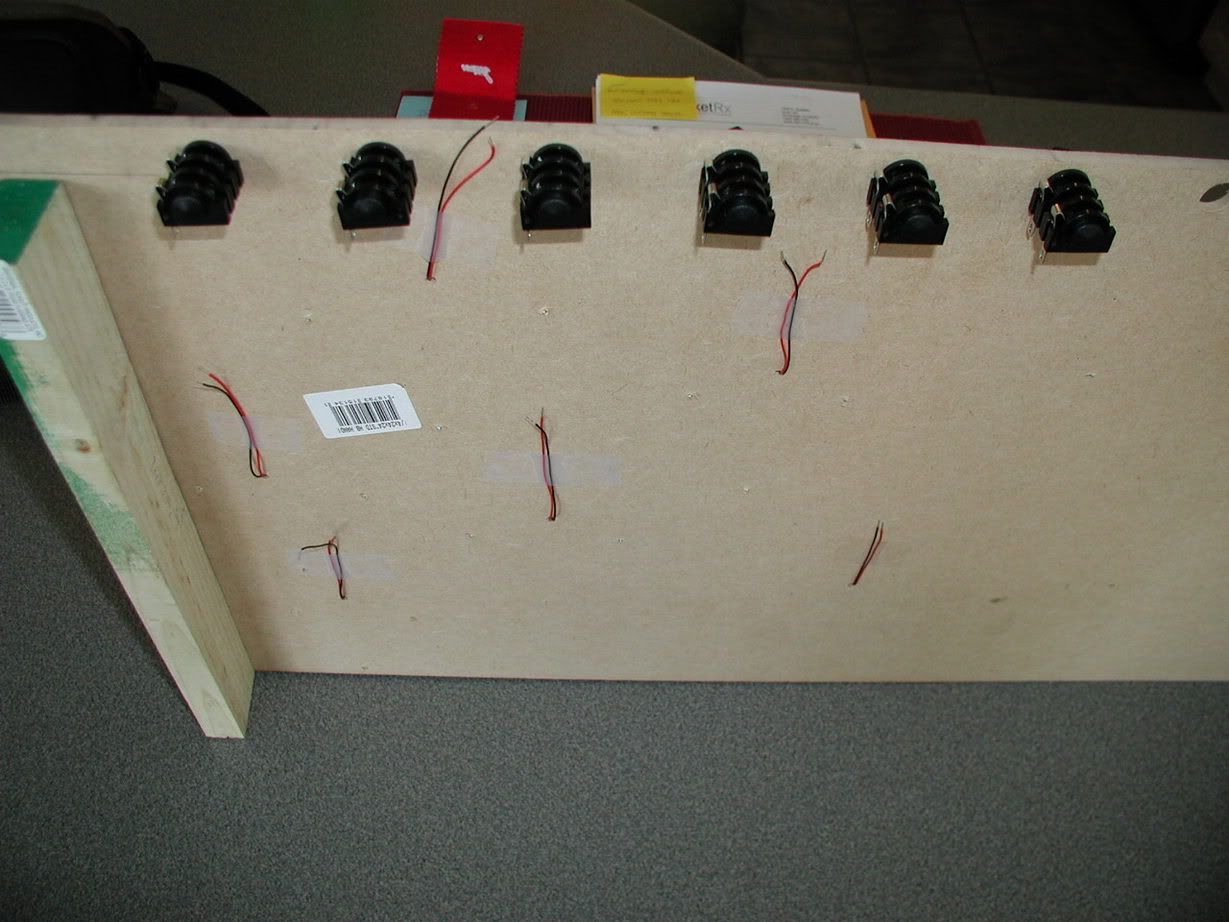

DIY digital drumkit in production
Part I.
I recently decided to go with a module off Ebay and DIY triggers for drums, instead of a programmable drum machine or computer-based program. Maybe my silly escpades will help people attempting to do DIY digital drums. I know there are several websites about it, but this is even more stripped-down, smaller than the rack-style, better laid out (and many more triggers) than the Yamaha DD line, and probably the cheapest way to go.
Components:
The module is a Yamaha TMX. I obtained 12 piezo speakers (aka triggers) and 12 1/4" jacks from Mouser. The board is a 1' x 2' piece of particle board from Home Depot. The triggers will be glued with epoxy to soup and coffee can lids (the smaller coffee cans not the huge ones). The lids will have a thin layer of a packing-type foam sheet between them and the board, and I picked up bulk mouse pads off ebay to cut up for the tops of the pads (which will be secured with silicone). The metal discs will be screwed into the surface of the board.
The wires from the piezos will go through the board and will connect via extender wires soldered to the jacks. The bodies of the jacks will be under the board, and the inserts will poke out the top of the board along the top edge. There'll be 11 pads on the board (kind of set up like a drum kit), and for now, one kick. Kick is a $5 beater off ebay, which will be fastened to a wood L-shaped piece with another trigger sandwich.
For now: I did a quick test run with two triggers, and it looks like it will work OK. I didn't get false triggers from the adjacent trigger pad like I was afraid of. It is velocity-sensitive too, and very reactive to the touch.
Rough Prices so far (minus shipping, since that varies):
Module: $100
6-pack of 3-foot 1/4" cords (ebay): $15
12 Piezos and 1/4" jacks: about $25
10 mouse pads: $5
Particle Board: $5
Glue and silicon: $8
Screws: $3
Bass pedal: $5
Total: $166
Maybe with shipping: approx. $210
Other:
extension wiring, solder, drill, coffee can lids, foam sheet, 6 more guitar cords: had it already
I'll post pics when done, and if all works out, a test run in which I'm playing the drums in a song.

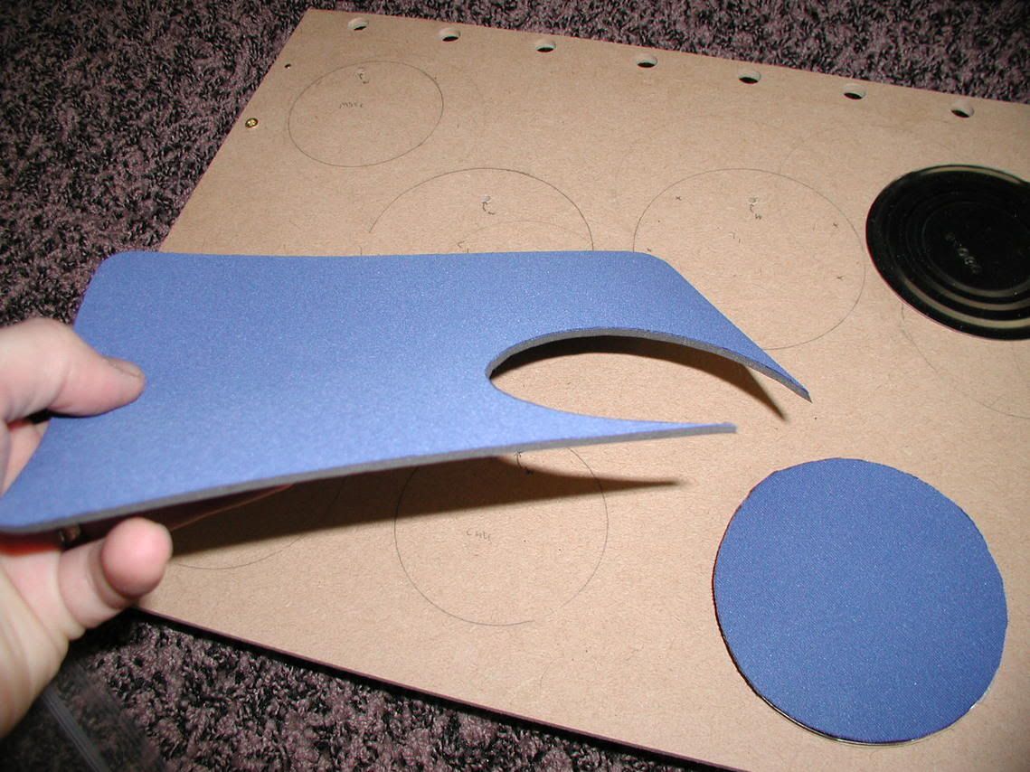

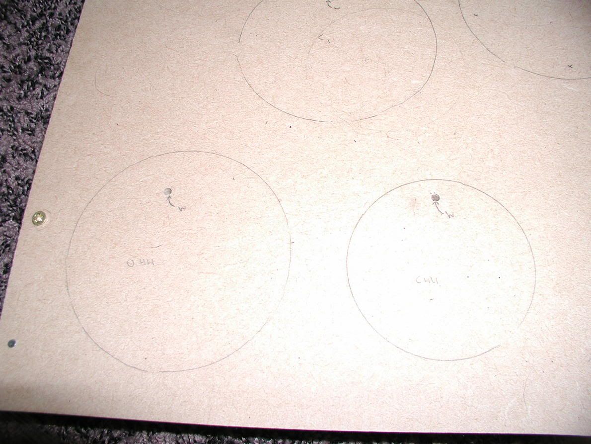

here's some pics of the thing in production:
http://i45.photobucket.com/albums/f8...a/P2040028.jpg
http://i45.photobucket.com/albums/f8...a/P2040032.jpg
http://i45.photobucket.com/albums/f8...a/P2040031.jpg
http://i45.photobucket.com/albums/f8...a/P2040037.jpg
http://i45.photobucket.com/albums/f8...a/P2040043.jpg
http://i45.photobucket.com/albums/f8...a/P2040044.jpg
so, the board basically has the following triggers:
snare, hi tom, med tom, low tom, ride, bell, crash 1, crash 2, open hihat, closed hihat, and misc (cowbell, sticks splash, china, etc.)
update:
after connecting 6 of the pads, it seems to work pretty good. I've just been running through pre-sets and haven't messed with the sensitivity options of the unit, but there are some false triggers and some no-triggers. These may be correctable with some fine tuning of the velocity settings. I found that a thin, flat piece of metal (one from an instant cocoa container) works a lot better than a thicker soup or coffee can type that has many ridges.

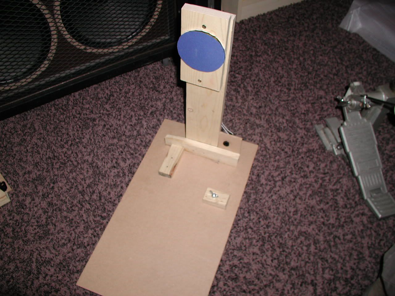

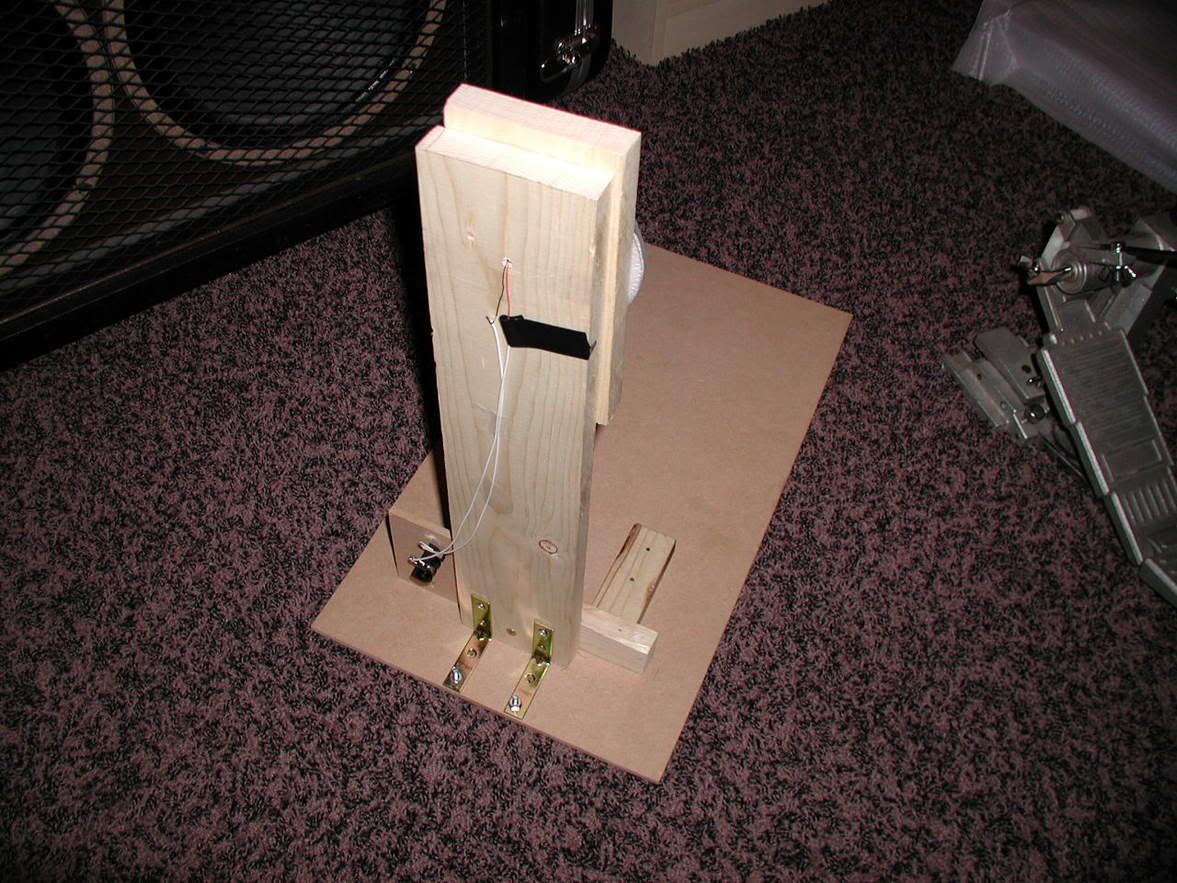

The board is complete, and the kick drum trigger unit is almost complete. A little tweaking, and I'll have a soundclip with guitars and bass by this weekend, as well as pics of the final product.

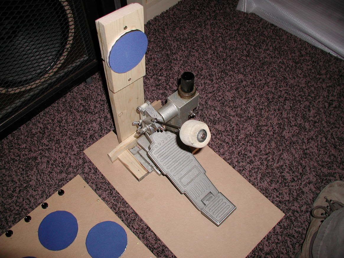

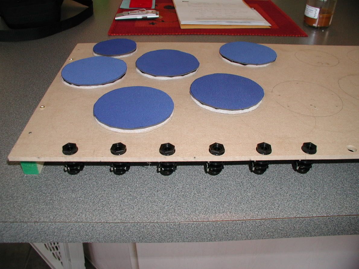

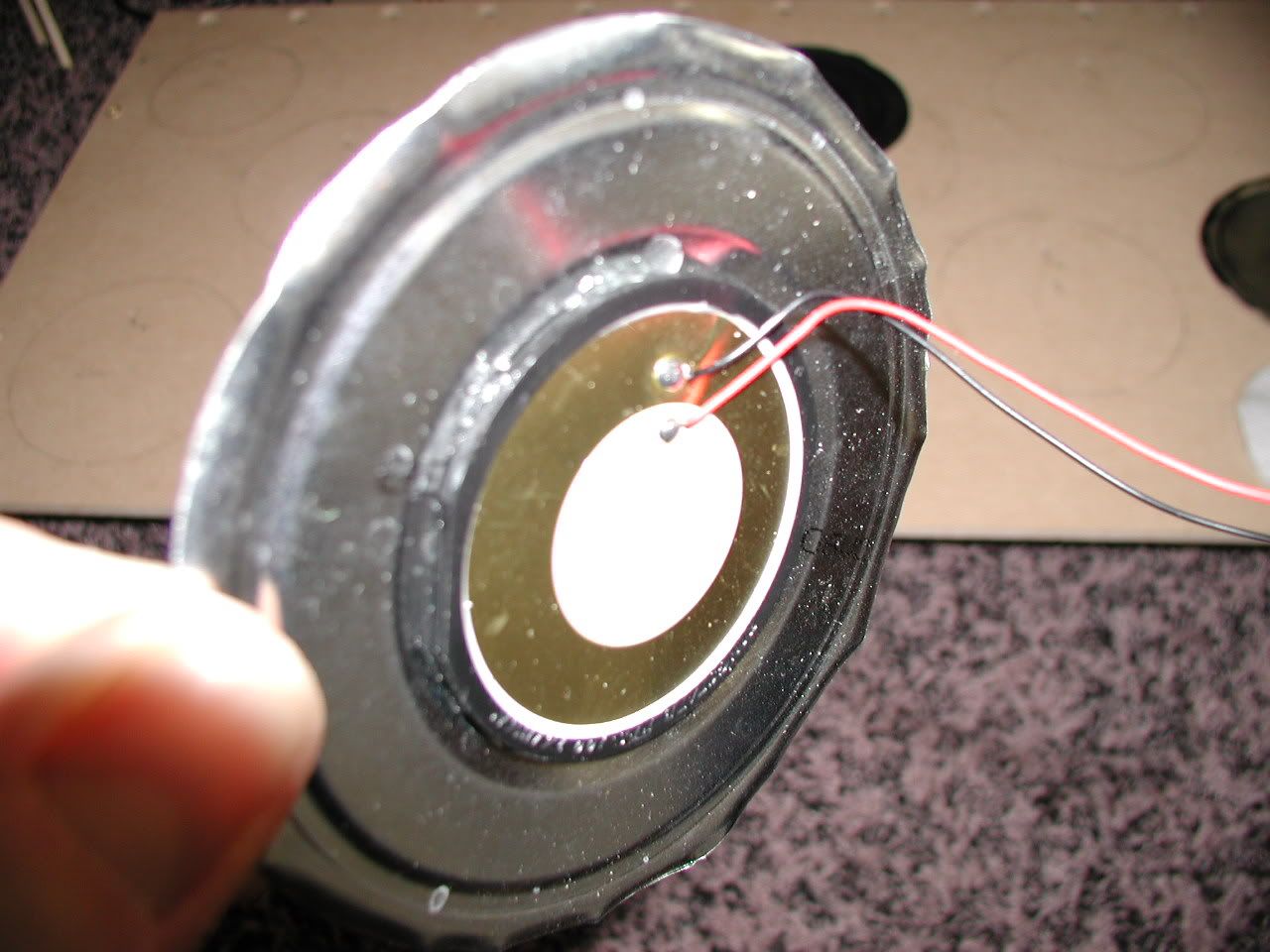

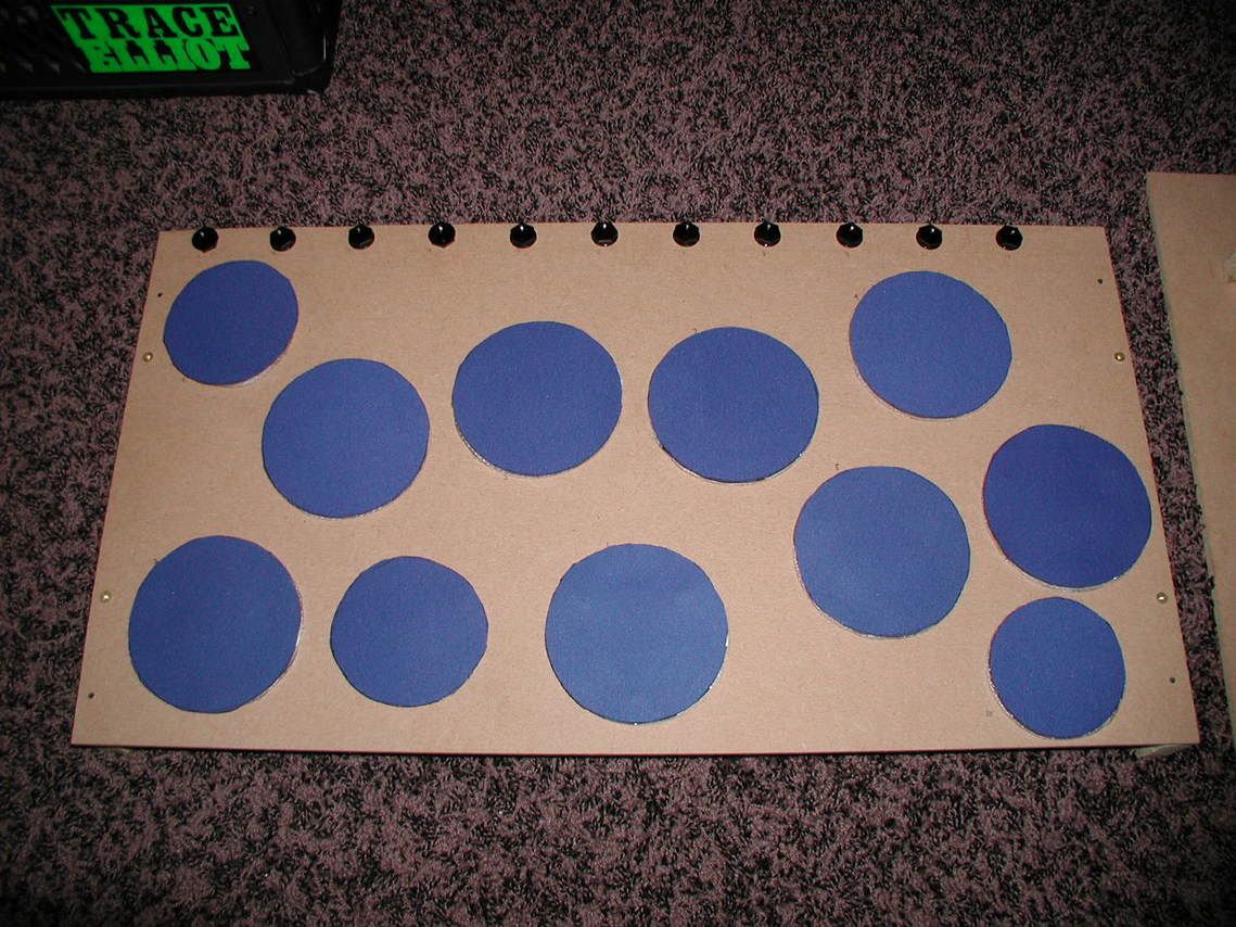

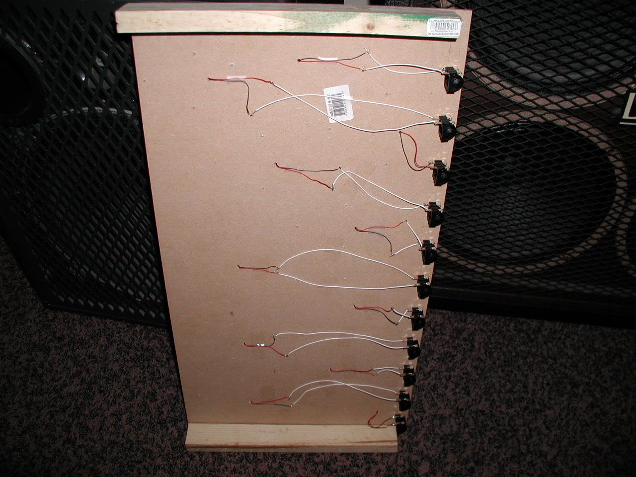

final pics of the board and pedal assembly:
http://i45.photobucket.com/albums/f8...a/P2100047.jpg
http://i45.photobucket.com/albums/f8...a/P2100048.jpg
http://i45.photobucket.com/albums/f8...a/P2100049.jpg
http://i45.photobucket.com/albums/f8...a/P2100050.jpg
http://i45.photobucket.com/albums/f8...a/P2100051.jpg
soundclips to come.

grab one of those small remo practice pads to mount on your kick jiggy ma bob thingy
http://www.musiciansfriend.com/produ...ies?sku=442966
how's the home made board working out so far? any sound clips yet?

good idea. I think I'll need to incorporate a practice pad like that for the kick.
Board is working pretty good. All triggers work, but I just haven't had any time to learn the module and program what triggers are which.
I hope to have a sound clip tomorrow after I program it...

You could also try rigging the kick drum pedal with a spring or an elastic of some sort to provide that extra bounce...
Try sandwiching the trigger Assembly in several layers of foam.
That way you'll have more foam to lay into, and it should be more like a loose kick head. Then tighten the compression spring on that pedal a little.
That's a killer Tama Kick pedal, by the way. They screwed up big time when they quit making those. Everybody started bying the Camco model because it was about $50 cheaper., but it's not where near as good as the model you have.
Tim

Sorry for the long delay....took me awhile to figure out the unit and then record. The final out come is....they are damn hard to play. I can't seem to stop the false triggering and sometimes no triggering during recording. Then I'll check it, and it will seem fine. Must be my nervousness or over-excitment when the record button is on.
I had to do record a song in stages because of my screw ups and the unit's (actually my poorly-designed board). I ended up sounding like a caveman (if you were to give a neanderthal a drum set and put him in a studio). Hence, the name of the new tune: Caveman Jam.
If anyone else tries the triggers all-on-one board thing, be very cautious, and use many layers of padding between the triggers and the board, or build little stand-ups off the board to prevent cross-triggering. If Yamaha's DD-50/55 gets around that problem...my hat is off to them. I would personally recommend going with separate triggers on a rack or something. Maybe the Alesis or Roland units would act differently, but I'll never know (or at least won't for a long time).
I think in the future, I'll need to record things not only in sections of the song, but also in drum sections (snare and bass, then the toms, then the cymbals, etc.). This may work to my advantage though, because then I can put them on different channels for more control during mixing.
Sorry for the long post.

Okay,
how did you mount the triggers to the board?
Are the can lids mounted directly to the board? If so, that's going to cause all sorts of crosstalk and false triggering. You have the mount the metal pieces on foam, so that they float.
If you attached the directly to the wood - you'll have to rebuild it.
What you need to do, is use a hot glue gun and glue a foam "ring" (just a foam strip glued around the edge of the metal) between the wood and the metal to act as an insulator/isolation so that they strikes don't pass from one pad to the next.
I would have made fewer pads on the unit, and made them bigger.
