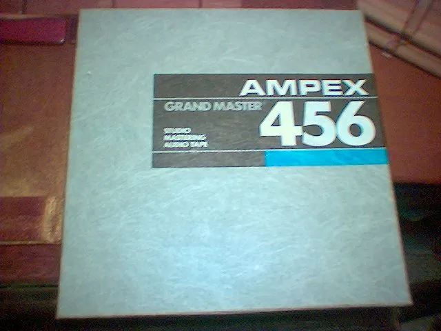

Hello all, I just wanted to let everyone know that I took my 388 into a specialist of teac/tascam gear and they found 2 fuses blown. It is up and running again.
Okay, so I have one more question. Is it going to be bad for the machine to use Ampex 456 one pass on the machine if I set it up for that initially? and what is the deal with this "sticky" that I am reading about...what are the dangers and how serious is this possible problem.
I included a picture of the box the tape came in.
Thanks for your help so far everyone. I just got my manual in the mail today from tascam. too!!
If the tape is the same age as that box, it's a bad one. There's a certain amount of luck involved, but it's quite likely that the oxide will come off the backing and gum up the machine.
If it were me, I'd throw the tape away and keep the spool. Buy a 10.5 hub-only reel, and wind half of it onto the empty spool (you'll need a machine that can take 10.5" reels for that).

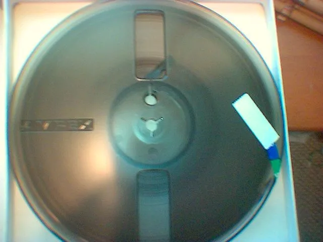

I bought the tape one pass...so the box may be old. Does anyone know what the reel would look like for the tapes that may ruin my machine??
Thanks..I will include a picture of the tape.

Save yourself some grief and spend the 13 bucks on some new 407 qauntegy. The 456 tape you have could be a problem.

It won't ruin your machine if it has sticky shed ..... it'll just gum up the heads and they'll require cleaning. And you can bake the tape and it'll be fine. Just do a search on sticky shed and you'll find out how to do it.
If you play the tape and can hear it squeeking on the heads it has sticky shed or if the playback is really garbled .... probably stick shed.
Bort 9
That box is from the sticky-shed era. Baking is fine for recovering music from a tape. Buying used "one pass" to record with, especially from the sticky formula days, is a bad idea. It won’t ruin your machine, but cleaning sticky-shed from the transport is a nightmare. It takes several cleanings to get it all.
Buying one-pass tape can be one of those “spend a lot of time and money trying to save money” sort of things. First, with all the new tape available there is no good reason to. Second, once a box is opened you don’t know how much it’s really been used. In fact, you can’t even be sure the tape on the reel is really what the box says it is. Basically you have a zero quality control situation.
Another issue... 456 will work on the 388, but it's thicker than what TASCAM recommends. Quantegy 407, 457, RMGI LPR35, or Maxell 35-90B will perform better on the 388.

You can't tell by the reel because Ampex used that same style reel before and after they switched to the new formula tape.
