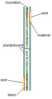

Ok been thinking about ventilation and have come up this a plan. What about having a vent at the bottom of the outer layer of plasterboard, and have a vent at the top of the inner layer. Having insulation better the 2 layers to absorb the sound, and having fabric behind the vents so as to not allow any insulation fibers into the room, but still allow the air in/out? (check out attached pic)

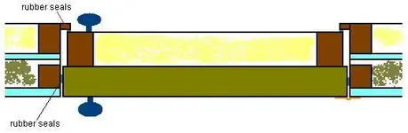

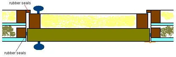

Would this door be ok?

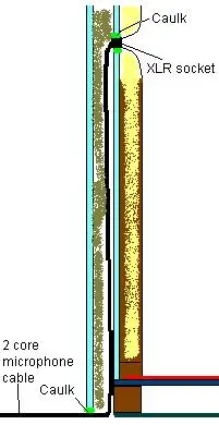

Idea for cabling, would this work/be the best idea? Ohh i have such an over-active imagination, lol
