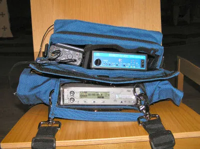

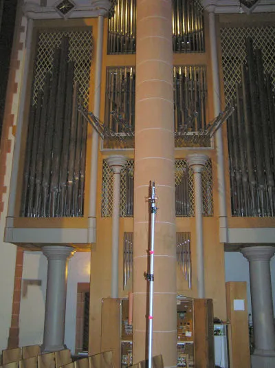

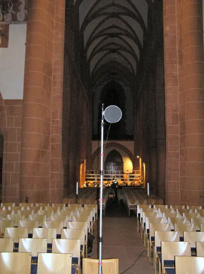

Exclamation Samples of the Jecklin Disc/Baffled Omnis/OSS method on a pipe organ.
http://www2.sendthisfile.com/d.jsp?t...M9JLDnkLxluJ9H <<(sample)
the chain was: DPA 4061s(mounted on a jecklin disc)>>>dpa mma6000(pre for the 4061s)>>>mytek stereo 192 adc>>>sound devices 722 hard disc recorder.
pics below as well. The original file was recorded at 24/96 and converted to mp3 with Wavelab 5.01b
http://www.josephson.com/tn5.html
info on this method can be found in the link directly above.

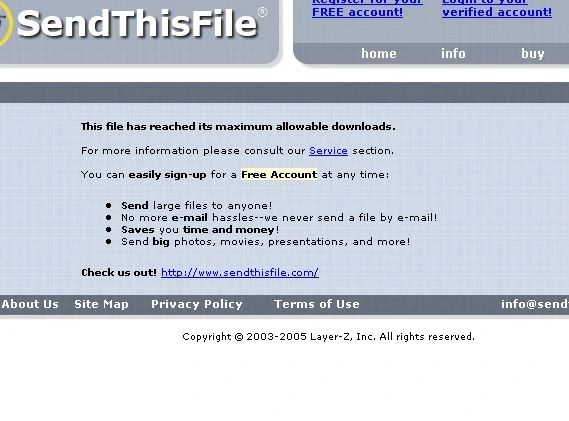

Well, I clicked on the link - and here's what I got:
- Wil

Thats why i put reply #4 (another place to download it)
Teddy
