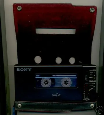

The Sony is the "SONY WALKMAN PRO WM-D6C CASSETTE RECORDER".
It is a Walkman. It will record to cassette tape in stereo format.
It is pocket sized and has the following key features:
Dolby B.C noise reduction
tape type : normal,Cr02,metal
tape counter
record level indicator and battery indicator
headphone volume
tape speed tune on-off fast-slow
line in
DC in 6V
mic attenuation 20dB - 0dB
record level
mini jack stereo mic input

The SONY Professional cassette recorder WM-D6C was in fact not a truly professional recorder from Sony in that it was part of their consumer product line-up for several years and hovered around the 3 - 6 hundred range. It recorded at standard 1, 7/8 IPS speed and had exceedingly compact internal circuitry to save space and to save power consumption, driven by 4, AA penlight batteries.

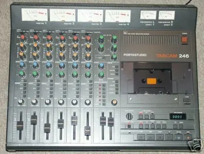

The TASCAM 246 Portastudio was in a much higher class of fidelity because of its superior/faster running speed of 3,3/4 IPS and powered by a higher degree of discrete circuity signal support and loads more headroom thanks to the built in dbx noise reduction and a healthy power supply to drive it all including its respectable 6 channel mixer.
The Sony was at best, a nifty techno toy of its day because of the advent of bootleg recording concert underground popularity and for those who wanted to do a bit of field recording of dialog and sound effects of which I too was an owner and user of one during the production of a concept album done back in 1987 by myself and a good friend and band mate.
We used the WM-D6C to record original folly samples that would be used later in the project for effect while blending songs into each other in concept album format. It performed admirably for its task with us, sounding clean and quiet enough with Dolby C engaged netting a 75db s:n ratio which was more then quiet enough for our work with it.
Your question is a bit of a bizarre one in that the two units you seek comparison on were intended for very different markets and end users. Almost like asking how does a go cart compare to a Roman royal chariot, carried by slaves.

The Tascam 246 is a Portastudio.
It also records to cassette tape, but that's where the comparison ends.
The Tascam 246 has the following key features:
~ Records 1- to 4-tracks simultaneously
~ Overdub capability
~ Single- and double-speed tape speed
~ dbx noise reduction
~ 6 mic inputs
~ 6 mixer channels with 2-band EQ, Pan and Inserts
~ 6 VU meters
~ RTZ, Cue and Endless-Loop playback modes
~ Tape Cue monitor
~ Digital tape counter
~ 2 headphone jacks
The Tascam 246 and Sony Walkman Recorder are two very different units, with two specifically different applications.
Technically speaking, the Tascam blows the Sony away.

Ghost refers to the S/N ratio on the Sony Walkman recorder as about 75db with Dolby C.
Tascam specs the 246's S/N ratio at 90db with dbx.
