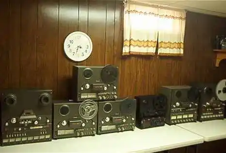

Well my atitude is unless you really need the money why sell any of it.
It never hurts to have a spare sitting around.

That pic is better than porn could ever be.

^HAHAHAHA!
Yeah, it's not that I have a negative attitude, it's that I barely had enough money as it is to get it for 100 bucks. I'm only 16, I don't get all that money. I do have a job, but I only work like 6-12 hours a week, on minimum wage, so it's kind of tough, I don't know how on earth I'm going to pay for maintenance to be done. For example, someone told me I need to like reverse the ring and tip of the xlr cables that I plug into the input, because the machine is balanced or something. For someone relatively new to all this, that makes no sense
