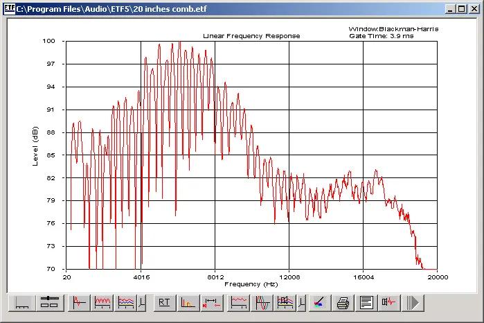

David,
> What is it? <
Comb filtering is a series of many evenly-spaced peaks and nulls in the frequency response. A graph of the response looks a little like a hair comb, below.
> will it help with bringing out the bass and kick? <
Not really - it adds a sound like a flanger effect. HERE is an article I wrote for EQ magazine that explains comb filtering from an acoustics perspective. There's also a video on my company's site that explains comb filtering with visual and audible examples. You can find that if you follow the link below.
