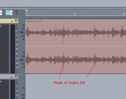

I wouldn't bother comparing the loudness of your mixes to commercially produced CDs. They will probably always sound louder, and yet mastering has a lot to do with this.
I had a listen, and imported the file into Sonar. It's not bad, the only thing I noticed is that the snare hits are a huge peak in relation to the rest of the mix (see attached pic). You could try a little bit of compression on the snare channel to tame the peaks, which would allow you to bring the rest of the mix up a bit in level.
But I don't know why the aiff file made winamp jump around more.. Might be a bug in winamp. I would try exporting the aiff as a 16 bit file the same as the wav and see what winamp shows.
BTW, nice sounding stuff. Maybe a bit too much reverb on the guitar for me but other than that sounds good.
