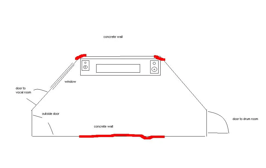

here is a sketch i made in paint of ABOUT how my room looks. the back big w alla is about 18 feet wide.
and from console wall side to back wall side is about 13 feet
i marked in red where i have 15"x4' rockwool sheets covered in fabric, and framed. the ones on the back wall are about 1.5" off the wall and the ones behind the monitors are just standing there. my room still has terrible bass cancelation. where should i put more traps?
also, is it possible my controlroom is just TOO small?
BTW im mixing on KRK Rp8s (overkill i know)

sorry, heres the pic

Freakk,
> from console wall side to back wall side is about 13 feet <
That's the big problem, and the fact that the wall behind you is cement. Since it doesn't look like you can rotate your setup, the best thing you can do is put the biggest, thickest, baddest bass traps you can on as much of that rear wall as possible.
> is it possible my controlroom is just TOO small? <
The larger issue is that your speakers are firing the short way across the room. They should be facing the long way.

ethan, would it be possible to double layer my rockwool panels? im going to cover as much as i can, but what if where i have existing traps, i put another layer on top of them. (i have the room) would that be worth the work?

Freakk,
> would it be possible to double layer my rockwool panels? <
It makes much more sense to put more traps in new places, like lining all of the wall-ceiling (and even wall-floor) corners.

ethan, honestly, is there any way my room is going to sound anywhere near true? cuz i just put some more bass traps on the back wall, and on some of the side walls, and theres soo much bass cancelation, and now there is this muddyness to the sound. i hate this, i wish i could just havea bigger room, but thats not gonna happen for a while. what are some of my options?

> what are some of my options? <
See my Post #5 above. Also line the entire rear wall with 12 inches thick fiberglass. Rigid fiberglass is best, but fluffy is much cheaper and almost as good once you get to a foot thick. If you have room for two feet thick, do that.

no, i understand about cancelation, there used to be NO bass whatsoever... now t hat ive put some trapping on the back wall, there is a slight increase, but there is a strange muddieness to the sound, i dunno.
