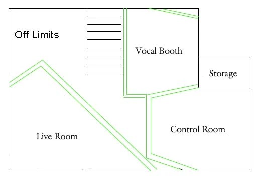

I'm not sure of the scale, but here's an idea I had.......maybe someone else can improve upon it.

Hahaha, good idea Thane, but dude's 15.......on a limited budget.

oOoOops!!! Must have over-looked that.
