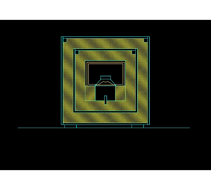

Quote:
It sounded like i could have made the damn thing out of tissue paper.
No doubt. Even 1 foot thick concrete will transmit at certain frequencies. The problem is an AIRGAP!! What you need is a DECOUPLED BOX WITHIN A BOX.(TWO LEAF ENCLOSURE) with at least a 4" rigid fiberglass filled airgap. You also need to line the interior box with rigid fiberlass. You can even rest the speakerbox and mic within and on the fiberglass. Personally, I'd make this a dedicated box with a caulked lid on each of the leafs, and float it on neoprene pads. Here is an ILLUSTRATION, although there are many ways to interpret this.
Actually, I wouldn't use a tupe amp because of the heat. Personally, I'd uild a speaker box as part of this. Use an XLR panel mount jack for the mic, and one for the speaker lines. That way you maintain the airtightness integrity.
fitZ

  #12
Old 08-24-2005
Nutdotnet Nutdotnet is offline
Dedicated Member
Join Date: Mar 2001
Age: 28
Posts: 455
Rep Power: 9
Nutdotnet is on a distinguished road
You're my hero Rick...that's awesome.
Reply With Quote

Great info Rick.
That might be exactly what i do someday, or with this eventually, but for now, I think I am going to have to live with some compromise, less noise, but not quite the perfect solution. Hopefully treatment will go a long way toward doing the trick.
I am now a little concerned about the tubes after a couple comments, how hot is too hot to be in there?
Daav.
Reply With Quote
