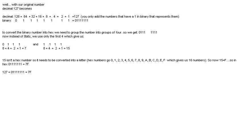

let's try this again, my previous post didn't format the way i typed it...look at this pic

basically just remember the pattern 128, 64, 32, 16, 8, 4, 2, 1
if you are given a binary number that is NOT a multiple of 8, you have to add the 0s to it. like fraserhutch gave you 10101
well, add three more 0s to the front of it to get 00010101
now add the numbers uptop i gave you to their corresponding 1s.
128=0 so that's no number to add
64=0
32=0
16= 1 so put that number aside
8=0
4=1
2=0
1=1
now add all the numbers you got 1 for.....16+4+1=21
tada!!
does that help?

so 16 is
00010000
& 17 is
00010001
HOT DAMN THANK YOU SO MUCH!
