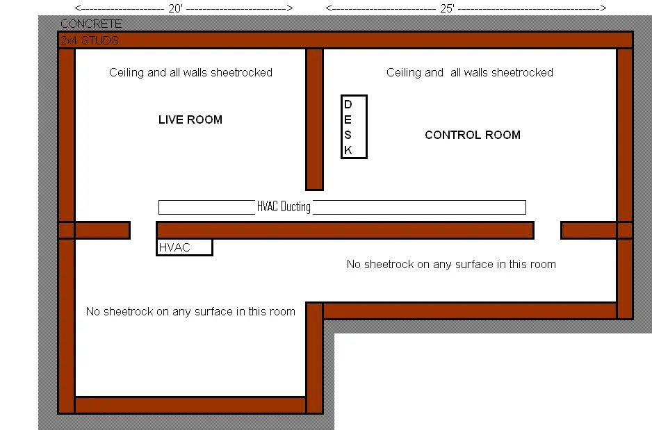

Admittedly I'm making a lot of compromises, but am trying to do so without wasting time and money.
The ducting we're talking about is common to both the control room and live room (downstairs) and the upstairs. I've closed off the ducts in the live room and plan to use fans when necessary to move air in and out of this room. The ducting will be covered by two layers of sheetrock, this is my attempt to minimize the amount of sound that makes its way from the live room to the control room and upstairs rooms.
I've attached a drawing to clear things up.

As usual with home recording, compromise is the name of the game. I am no exception. In fact, I'm not wasting anything on isolation as my stuido is on a second floor. There is NO improving my floor considering how its built, where I am located, what I am recording and who will hear it. Mine is PURELY for my own pleasure and experience, so treatment is my only real option. Good luck Phyll, and by all means have fun. Oh, yea...go ahead with the drywall. Let us know how much it improved the isolation. Which is subjective without tests, but if you hear a difference, and its satisfactory to you, what the hell, great!!
I can see a few problems with shutting off the vents in the live room.....this is not sound related.......your hvac system was designed to move a given amount of air(110 cfm through a 4x10x6 run) 400 cfm per ton of cooling, a 3 ton system would need to move 1200 cfm to operate properly.....when you go shutting down vents.....you comprimise the efficiancy of the system and with enough vents shut down you could damage the system, like having freeze-ups, liquid refrigerant making its way back to the compressor which will blow the valves out of it or wash the oil from the crankcase and burn up the compressor. Also....shutting down vents will cause noise in other rooms of the house ......that air has to go somewhere! I would suggest leaving your hvac intact and do what I do......when I record a vocal track.....I turn it off!.....BTW.....I am an hvac service tech(25 years)
