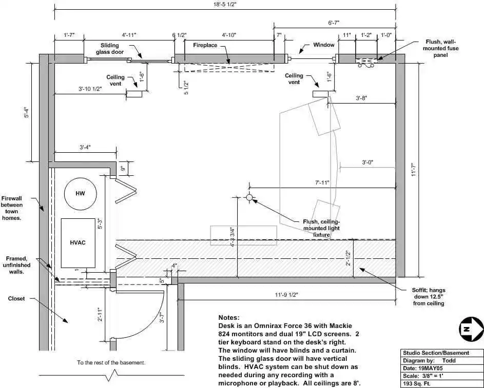

Here's the layout of my studio. Desk and equipment positions have yet to be determined, but I'd like the desk facing north, as shown in light gray. Opinions? Is three feet from the wall okay?

Ah! Help. I have a question. I'm setting up my room now and am unsure of how to use the 38% rule due to the split South wall. My desk will be facing the North wall. Should I place the desk (18'5.5" x 38%) from the wall or use the (15'1.5" x 38%) figure? That second distance on the East wall has a opening, so it's isn't even a solid wall the whole lenghth. I don't split the difference between the East and West walls, do I? I'm not quite sure what to do in this situation.

The shorter section has what looks like a "flexible divider" rather than a rigid wall, so you'll still consider the room as being the longer dimension.
