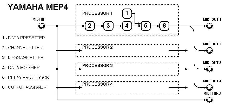

Wow, sorry to hear that. I've bought all those routers used and never had any issues with them. OK, I lied, the MSB+ has horrible buttons that bounce if you even think of pushing them. Other than that, no troubles. I've owned most of these for years.
I've attached a simple block diagram picture of an MEP4. The Channel Filter can be set to any one, several, or all to be passed on to the next block, the Message Filter. Here you can select what type of message to mess with in the next section. Which happens to be were the real work happens, the Data Modifier. The number of math function in the Data Modifier is pretty vast. You can do straight line equations, you know, like y=mx+b stuff. Reverse the data around a selectable data point. Or, have selectable limits on the data range. Others that I have forgotten by now. Also is a Delay Processor for simple single event delays up to 3 seconds. Lastly is the Out Assigner to determine what channel and port this new data will come out on. All four processors have these functions and can all be merged to the same port, if desired.
Search the net for a pdf of the manual, or ask me to send it to you if you want. I like the MEP4 so much I now own three and wouldn't hesitate to buy another.
