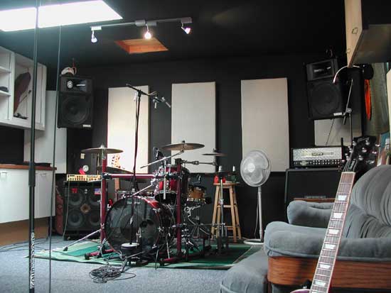

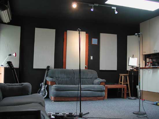

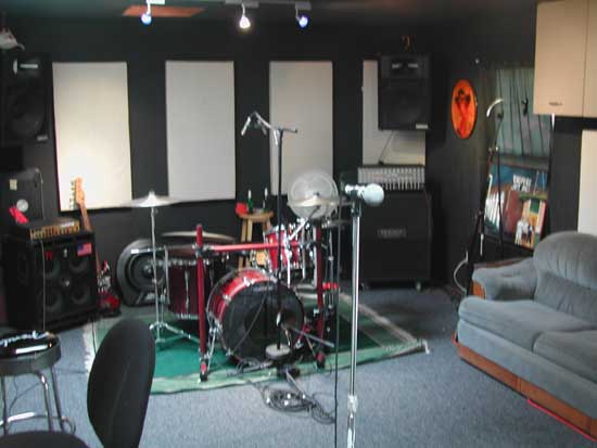

Here is how I attached my 3" rockwook panels to the wall.
Before wrapping them with Musin Fabric, I stuck two 1/8 x 4" toggle bolts through the panels about 5" in and 12" down from the top of the panel. I put fender washers on each end of the toggle bolt and then tigtened on the toggle part until it sqeezed the rockwool together as much as possible. (this will leave two small button like holes in the rockwool)
After, I wrapped the front of the panel in Muslin like a christmas present leaving the back exposed and the toggles sticking out the back. I then wrapped simple hanging wire around each toggle in the back like a picture frame. (Use 3M spray adhesive when wrapping the fabric.)
Here is the finished results:
This made a HUGE difference in the sound of my room. This room is 15x23x8.
Let me know if you have questions.
