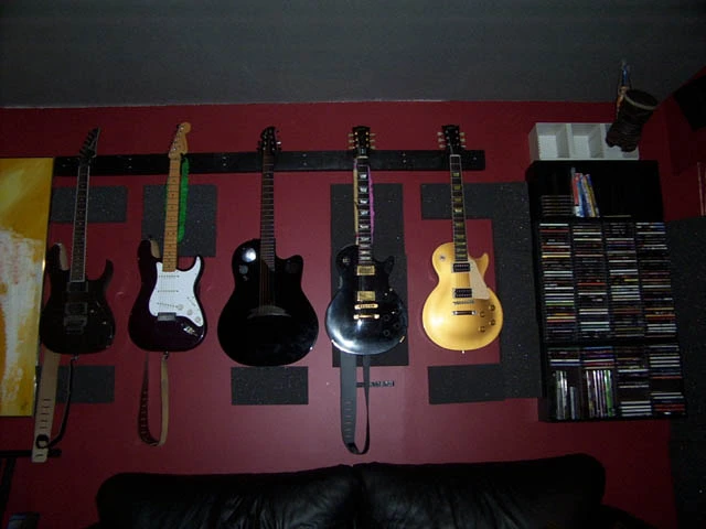

Go to Home Depot!!!! You will find padded utility hooks for $1.00 each!! drill them into a two by two or two by four after you paint it black and voila!!

the pic didnt work?

I sure hope those are not covered with vinyl, because if they are they will eat away the finish on any guitar with a nitro cellulose lacquer finish, such as the Les Pauls I saw in that shot, and maybe the Strat (depending on it's age). Most of the stuff I see at hardware stores is covered with vinyl.

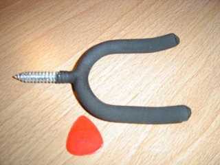

Hmmmmm.......I dont think these hooks are covered in vinyl but i could be wrong! They feel like some kinda mushy rubber.
Someone else posted this pic in a different thread but this is the EXACT hook I am using.
