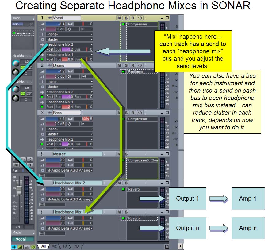

I am running SP3.11 with an Aardvark Q10. I need 3 seperate headphone mixes. Any tips on routing in sonar and the q10 outputs for different live mixes??

not sure about your hardware end of this but you can create 3 busses and then send feeds from each track you want monitored to each buss. You're creating a mix on a track-by-track basis but that sounds like what you want to do. The main mix and other busses won't be affected. On each bus you can also add whatever effects you need but if you're doing this for tracking purposes, you're best off limiting the amount of effects and EQ you use until after you get the recording.
On the output side, assigned the bus outputs to each pair of Q10 channels then take that into your headphone amps.
