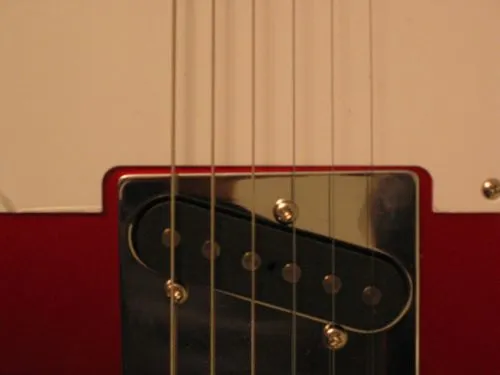

bought a jap fender telecaster and i have been worrying neurotically about some issues i've noticed, which i probably should have noticed when buying, but oh well aren't i silly.
firstly it appears as if the bridge or scratchplate is not fixed to the guitar how it's meant to be. it's hard to tell which. either the scratch plate is slightly off and i wouldn't too much, or else the bridge is at an angle and i guess this is more worrying.
secondly it looks/feels like the neck is attached to the main body at a slight angle, in the direction of the floor if you were playing the guitar. this is in no way noticable by looking at the guitar from a normal distance. however, when looking at the base on the neck, on the side with the cut away, the part of the body which follows the neck up with the plate on the back seems wider than the neck, but then and inch or so further up the neck, where the neck leaves the body, the main body is under the wood. sorry if you don't follow. i can barely follow myself.
these issues may be nothing to worry about - which is where i'd like you guys to comment. i feel sick thinking about it, because i have to travel all the way to london to the shop if there is a problem, and i don't wanna be sent back if they think i'm being silly. obviously a neck at and angle and a bridge not parallel are problems, but when it's this slight i'm not sure.
i've attached a picture of the bridge issue, the other is too hard to capture.

The spacing between the bridge and pickguard does seem a little off so it does suggest that either could be at an angle. Probably not a big deal other than the appearance. If it is the bridge that's slightly off, each string can be adjusted at the end of the bridge to compensate for the slight angle. The adjustments sets the intonation of the strings so they sound in tune correctly as you play up and down the neck. If you have the guitar in what you think is proper tune and it doesn't sound right, you may need the intonation adjusted.

If the pickups are lined up OK, then don't worry about it. It is just a cosmetic issue, and fixing it could be anything from really easy, to really fucking complex, depending on whether or not any of the screw holes would show when the pickguard was realigned. And of course assuming that it is not the bridge which is off, which is even more of a PITA.
Does it sound good? Does it play well? Are the strings ballence on both pickups? Yes? Then don't worry about it. Think of it as a defining feature of YOUR guitar. That makes it cool.
