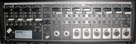

Arrow M-35, back
This M-35 back panel is missing two of the ACCESS SEND>RCV jumper plugs!................

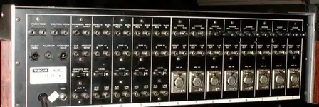

Arrow Tascam M-30's back panel.
