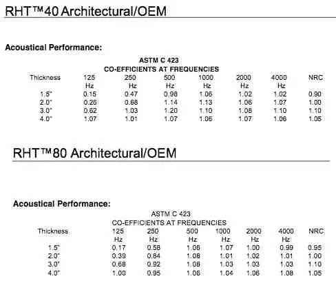

Looking at these specs for Roxul Rockwool, it seems to me that the 4# does have better absorption in higher freqs, however not by a lot really. The 8# has better absorption in the lower freqs, also not by much but still quite a bit when you think how much harder it is to get the lows. I would think that by going with the 8# you could absorb more of the lows and less of the highs and get a flatter room. Am I wrong in my thinking?

Not quite. The hardness/Density of the 8# will result in your highs getting reflected back at you.
So the 4# is the better balance between bth objectives.
I have the 4# behind me in my studio and my Bass meters flat.
