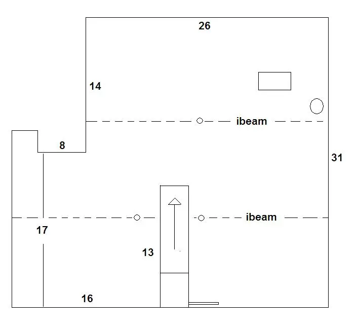

Goodevening boys. Hope all is well.
I thought a kick ass ms paint pic might help. Should be close to 3/16 scale depending on your resolution.
You guys can have free reign on ideas. I'm open to anything since it's all bare concrete. The rectangle and circle in the upper left corner would be the furnace and water heater.
Right now I'm thinking an out of the bottom right corner approach, or front wall being to the left of the stairwell.
The room is used for music and storage. That is all. Like I said. I would like to record vocals in the same room.
Thanks again.

No, you picked the right place to post this, its just that I'm (and I'm sure others) are confused.
You say you're into rock, classic rock, and punk, but then you go on to say that everything will be recorded direct. And thats OK... very workable and all, but it's not the method I'd use for a big, classic rock sound.
Let's start with some very basic questions;
First and foremost:
What is your building budget?
How much of the space CAN you use?
Bare concrete walls are horrendous for recording, mixing and mastering. Are you prepared to do EXTENSIVE modifications to the space?
How high is the ceiling?
Where are the A/C and heating units located?
Can you locate other utilities on the plan? (Lights, outlets, drain pipes)
Answer these while I think of some more questions.

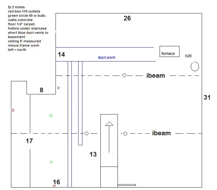

Ok Michael. I revised the floor plan. not sure if I can edit the first post so I will attach it here. If you need any more info. Or if I missed anything let me know. It also has the ceiling measurment.
I know I have a bit of mix going on here. A couple of reasons have left me here so I must move on towards what I want to accompolish. Rock would be my main gig but my tastes wander far. One being a lack of like minded musicians around here.
As far as sound I haven't found everything I would like to use. I'm sure I will end up building a isolation chamber for an amp. I experiment constantly
As far as the room is concerned.
Left = North. I've setup shop in the left corner for the past 3 years. This is the most comfortable, quiet place in the house. I live with my wife. No one really comes over. When I record no one is home and I turn everything that makes noise. Our Air conditioning unit is located on the southwest / bottom right corner. Two ducts pass through. That is all. I have free reign of the room. and the house for that matter. I have thought about recording downstairs and just mixing, mastering upstairs. My system is note book based until I can make a nice analog investment.
I've messed around down there with my live rigs for a while. Soldano hr 50, and such. I am way familar with the concrete now. lol
Through this time I have been experimenting with pieces of carpet and foam. Just make shift things I leave up in places while I play and playback cd's. Just kind of observing the beast.
To be honest I really need to do something down there. It sounds horrible, it kills my creativity and It has no feel. I figure if I spend 30 hours a week down there I owe to my self. Plus building runs strong in my family.
Personally I would like to keep it as simple as possible. I understand what it takes to make something top notch. Which happens to be my tastes. However someone taught me k.i.s.s one day. This will be my first build. My next will be in a new location.

Can you post any pic's of the space?
One on each side of the stairwell would be nice.
And what about those electrical outlets? Where are they?
Reply With Quote

oops! I forgot about the budjet. It depends on other purchases. I have to get some plans going. Once I come up with something I can figure out cost.
I am aware of the investment.
I really want a nice room in an enviroment or atmosphere sort of way. Not a work type pro studio look.
outlets = little red boxes I have three in my area.
I wish I could get some pics up. I have yet to purchase a camera
If you need a drawing I can do my best.
The stairs are bare underneath. the top of the stairs have drywall up to the ceiling, with studs supporting the dry wall. If I stand facing south in my area it looks like a wall cut diagonally with the bottom section removed minus four feet for the landing and EDIT ENTRY DOOR on the opposite side. Picture a unfinished basement with carpet and painted walls. paint is about 020 thick. Joices run east,west.
My home is a ranch.
One thing I've noticed is the i-beams. I wonder if it would be possible to build something contained within them or between one I-beam and a wall. They are very practical in my opinion.
