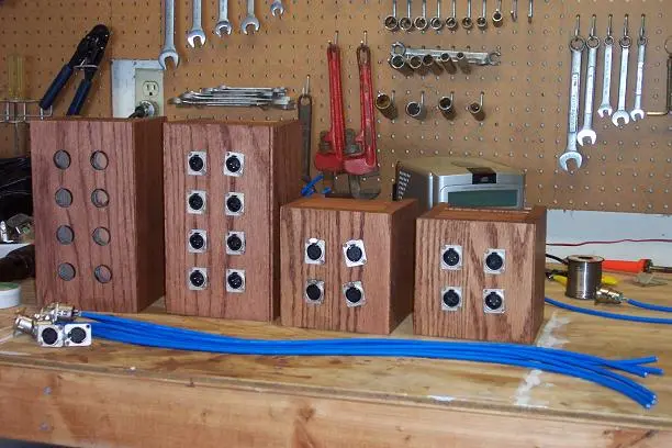

Hey guys:
I'm finishing up the wall plates for the studio, and I need to wire in some 1/4" stereo headphone jacks.
How do Ring, Tip, and Sleeve relate to Hot, Netural, and Ground?
(I think I have it in a book somewhere, but its in the attic, and I don't like going up there. Its spooky!)
Here's a picture of what I have so far.

I see XLR's but no TRS connectors - if you really mean 1/4" TRS, for stereo headphones it's Tip=left, Ring=Right, and sleeve is ALWAYS ground.
For TRS balanced mono, tip is hot, ring is return, and again sleeve is ground -
Bookmark this -
http://www.rane.com/note110.html
and you'll NEVER have to go into that scary attic again... :=)

Yeah, that's what I meant.
I have to drill out for the 1/4" TSR's.
The boxes are stained, but not lacquered or finished.
I'm building them out at my dad's place, and he thought he'd help out and stain them.
He didn't know they weren't finished.
