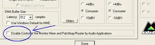

Dachay, what version of driver you installed? I believe version 5.10.00.0027 won't give you such warning, and you can change setting on the Delta panel while Sonar still run. There's also check box below latency pull down menu (Hardware settings tab) which lets you select whether you want to enable or disable control of the monitor mixer and patchbay/router by audio application...

I'm still using the last MME drivers that M-Audio released. That's because I am still running Windows ME, and I never could get the WDM drivers to work right under Win ME. However, since I don't really do anything that requires low latency, the MME drivers have been fine for me.
