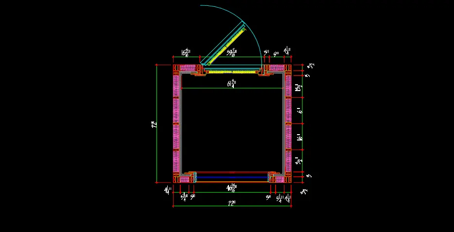

Here is a perfect 6'x6' standing wave enclosure
No treatment, or exterior shell shown....yet.

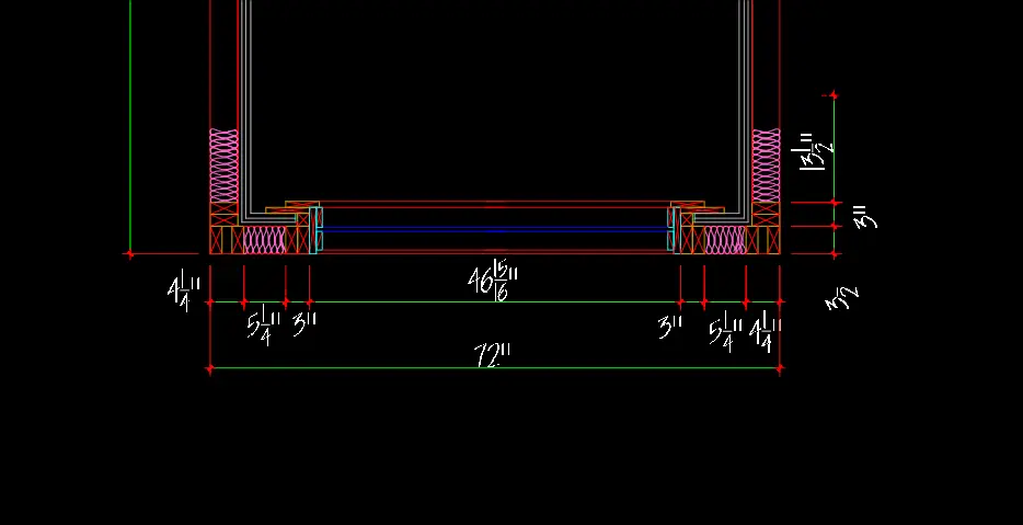

Here is a window detail. There should be the same in the exterior shell.

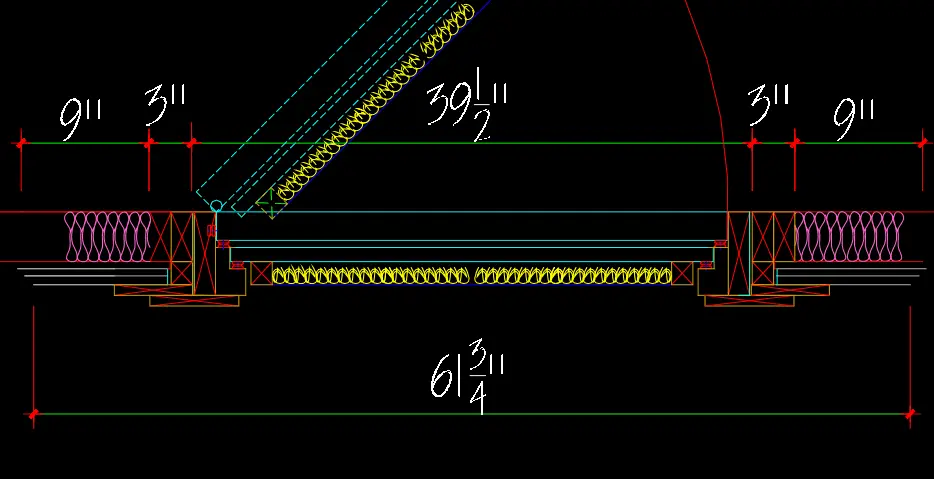

Here is the a custom door/jamb detail. Note the seals. This would be used IF you had a 3sided exterior shell, with another door to a sound lock on a wall from another room. I'll post a pic of that tomorrow. This is basic plan section stuff. 1/2" and 5/8" Gyp bd on resiliant channel, with R-19. I'll post Vertical and Longitudinal sections later with vent and plenum, electrical, floating details too. Later.
fitZ

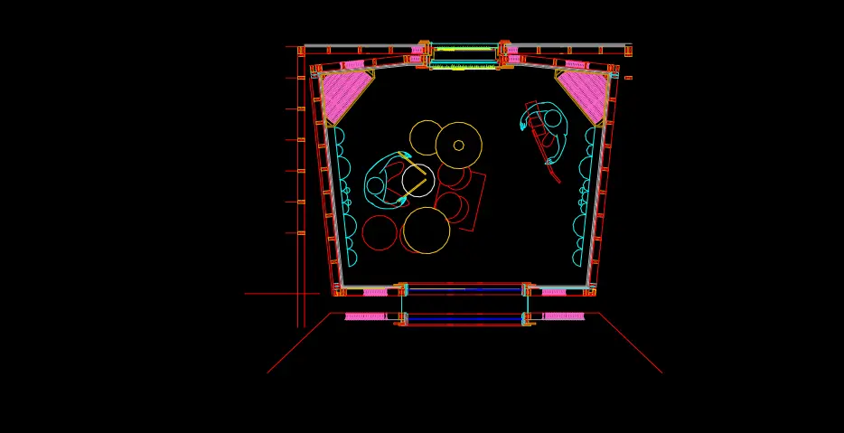

Although, this is more of what I had in mind.

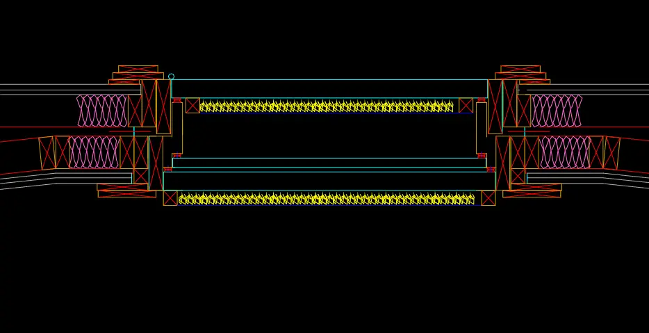

Here is the custom door/jamb seal for this one.
