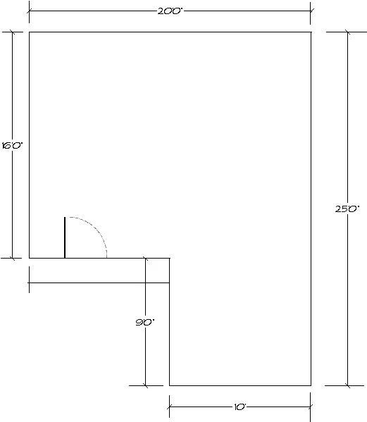

Jeff, a lot of people (including me) have a hard time visualizing a space from verbal descriptions - if you could do a basic drawing in Paint, labeling walls/doors/water heaters, etc, it would probably get you more answers. Also, if you have an idea of what may be wrong with your space, throw that out there too. I'll take a wild guess and say it's "boomy" - concrete walls don't give much, so bass doesn't tend to go away very well...

Is this it Jeff??

JKlein- photos would be good too, along with a layout. They are worth 1000 words, they say. Don't count on packing foam to do much. It is usually much lower density than acoustic foam.-Richie

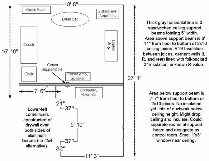

Here's a picture of how I've got it set up now. There's a bunch of stuff stored behind the mixer table right now; a big nautilus gym that I hope to move out into the finished side with the (also unused) bowflex and a huge amount of egg crate pink packing foam I've been saving from work over the last 2 years. I've really got an unlimited supply of that...sure it won't do _any_ good <G>? I could call my studio 'The Pink Room', haha!

Hmmm...let's try that picture attachment thingy again...server was busy.
