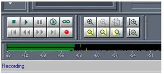

Here's mine with nothing in the inputs...I guess it's just my freaking card?

Yeah, I think I figured it out (with help from another site, lol)...your Delta registers about -96db (quiet freaking card), which is off the meter, which seems to stop at -75db.
However, if you right click on the meter, and set it to a 120db range, you'll see something.
Sorry for the interruption.

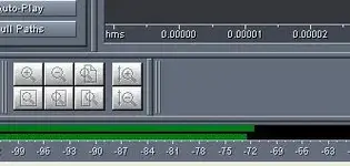

Unplugged -72
djbleach - you need to process your image (try a Weiss EQ-1) before posting.
Look for the "attach file" area when replying or starting a new thread.
