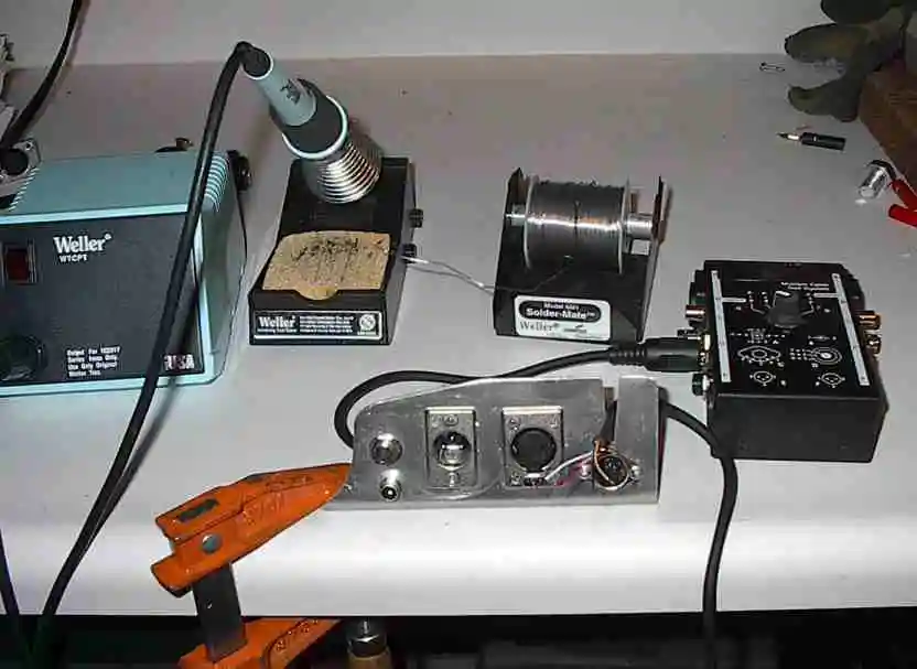

If you are going to be doing this a lot, make a soldering jig. I have fabricated an aluminum plate with male and female XLR, TRS, 5-pin mini-DIN, and RCA connectors all mounted on it. I can clamp that to my workbench, and then plug the connector I'm working on into the mating connector on the jig- that keeps it from going anywhere.
I also cut a slot in the jig that tapers from 3/8" to 1/8" to hold the wire while I tin it. I strip it, drop it in the tapered slot so that it can't go anywhere, tin it, then pull it out of the slot and solder it to the connector.
If I get a chance in the next day or two, I'll post a picture. But the way I figure it, having the right tool for the job is priceless: if you do more than 30 or 40 cables in your life, you're wasting time not to have one of these. I've probably put several _thousand_ connectors through mine, after building 3 studios now...
One other thing: a clever person might consider connecting the pins on the connectors on the jig all in parallel to a cable that would plug into a cable tester, allowing the cable of interest to be assembled and tested *simultaneously* while it is still in the jig... Just a thought (;-).
Hope that helps. I'll try and put up a picture tomorrow.

As promised: here's a picture of my cable maintenance station.
You can see all the connectors- the MIDI cable off the back is bridged across all of them in the correct pin order, so that the far end of a cable under construction can be plugged into the other side of the cable tester and tested while the solder is still cooling: regardless of what set of connectors the cable might have. It's a great timesaver. You can also see a cable dropped into the tinning slot, already stripped and ready to tin. Plug the connector insert from _any_ flavor of connector into the mating connector on the jig, and it'll be going nowhere while you solder it up.
The other thing you might notice is that the XLRs and mini-DIN are installed in what looks like upside-down orientation. This was done so the the solder cups on Neutrik connectors came out facing up- making them easier to tin and the final cable assembly much faster.
It's just a random scrap of 1/8" aluminum with some connectors on it. Build yourself one of these and cable building and maintenance becomes a very quick and easy task. You can do it with only two hands!
