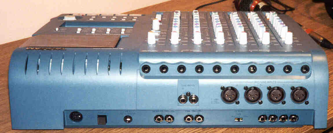

New! Check out detailed photos of
the top and the back
of this unit.

- Top access to the inputs and outputs are gone. This makes
the volume of the Mk3 smaller, but I found the top access to be really
convenient, functional and ideal. The way the input/output section sloped
slightly backwards so that the cables gently curved behind the unit...perfect.
Now, to plug cables in or out of the Mk3, a user has to bend over the
unit to see its backside, or lift the whole thing up to ones face
to. (Not so difficult as the Mk3 by itself is comparatively light).
